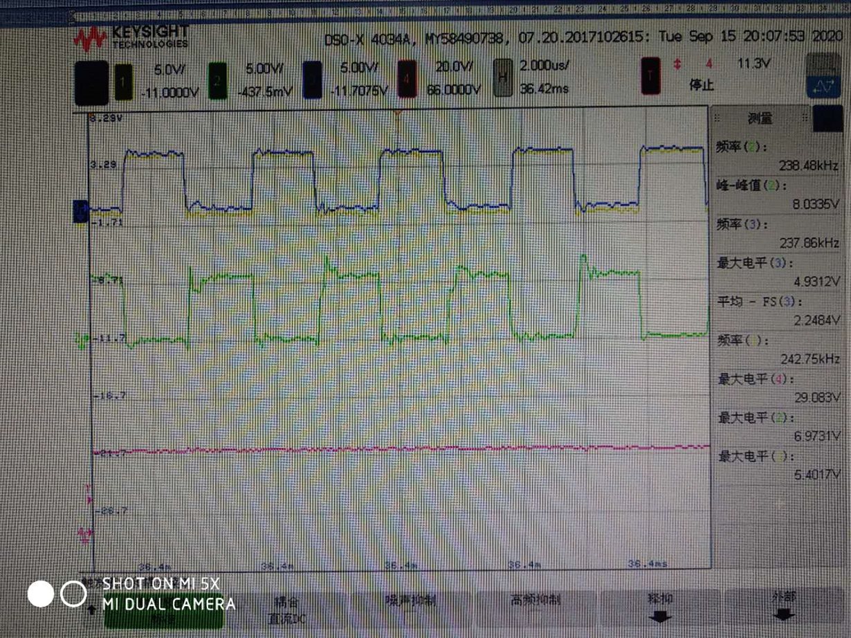

  • Hello,Sean
    I tried to increase PCM_BLANK to 100ns and 150ns, the prototype can be started, the waveform is as follows:
    In the above figure, the blue is a secondary synchronous rectification driving PWM, and the red is the waveform of the output voltage Vo.
    The prototype can be started, but Vo still has about 100ms jitter.
    I don't know why this is? Is the blank not big enough? When the tube was blown up earlier, Vo was shaking.
    The blue waveform in the above figure is the primary peak current sampling waveform Ipri.
    Compared with your development board, the waveform jitter is severe, and the triangle of Ipri is not obvious, and the slope is low.
    I don’t know how I can improve this Ipri. Can I increase the slope compensation in the software to increase the slope of this Ipri?
    Thank you.

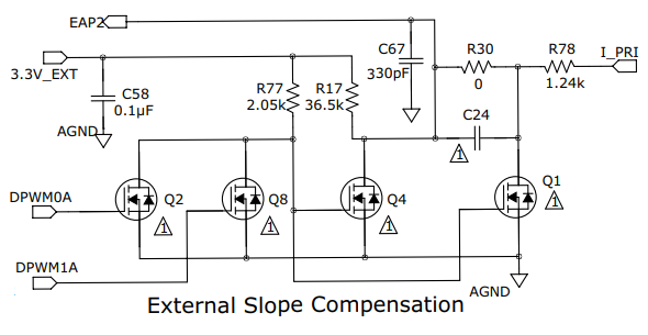

  • How much can this blanking value increase? Is there any bad effect on the circuit?
  • Isn't this external hardware slope compensation circuit added on the development board, but a DC level of about 100mV is added?
    Is the slope compensation compensated by software? How to modify the software to increase the slope compensation slope?
