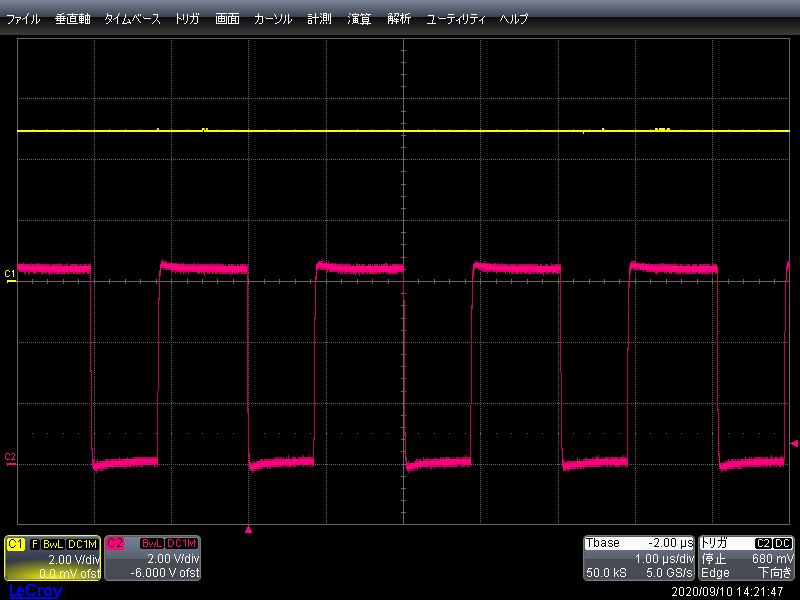

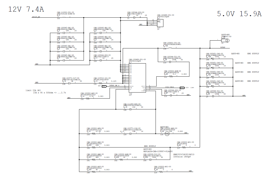

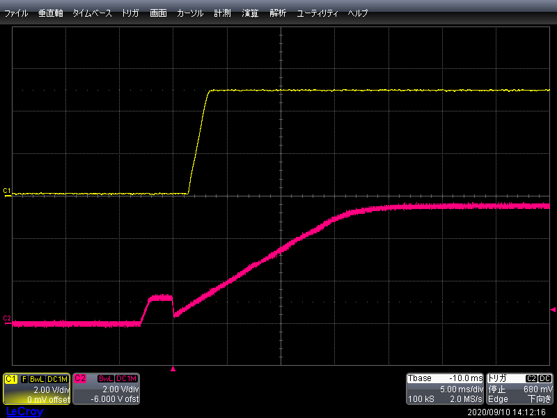

OCP doesn't work on customer's design as below.
Could you please review the schematic and give some comments?
ILIM resister is 2.7K ohm, customer is expecting OCP at 23A. But it doesn't work at the current, and also tried 30A, resulted no OCP.
schematic is here
