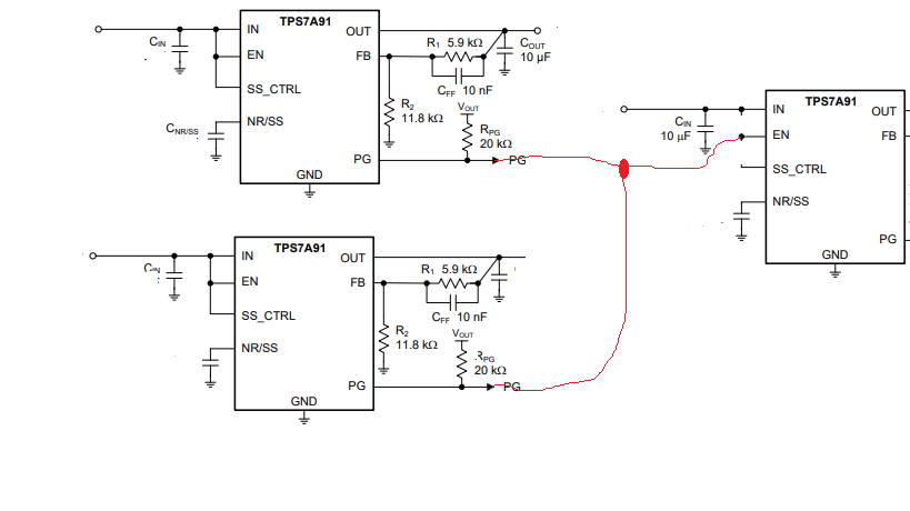

Hi sir,
Is it possible to use PG (5 pin) of two tps7a91 by cascading in the other tps7a91 EN pin like below.
As long as the customer does not exceed the abs max rating of the device, connecting the PG pins of the device to the EN pin will be fine.
- Stephen
