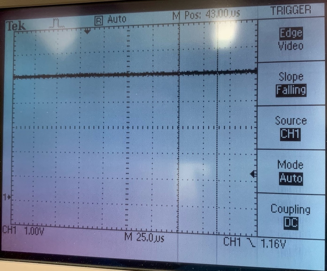

I’m using the TPS63030 on a design and recently found a weird issue while testing. Occasionally when I bring the EN line low, the chip continues to operate. Using an o-scope I measured ~0V (max of 100mV) right at the TPS63030 EN pin, but the output was still regulating to 5V and the inductor still showed a switching waveform. This behavior of operating while disabled doesn’t occur 100% of the time, but is repeatable. It has occurred both when the EN lines has been driven low by a micro-controller, and when manually jumpered to 0V. This behavior was observed on two separate assemblies.

    Figure 1: nominal VIN:

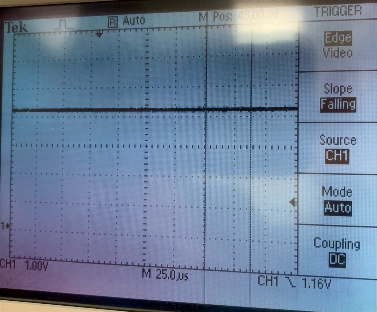

    Figure 2: nominal EN pin when EN pulled low:

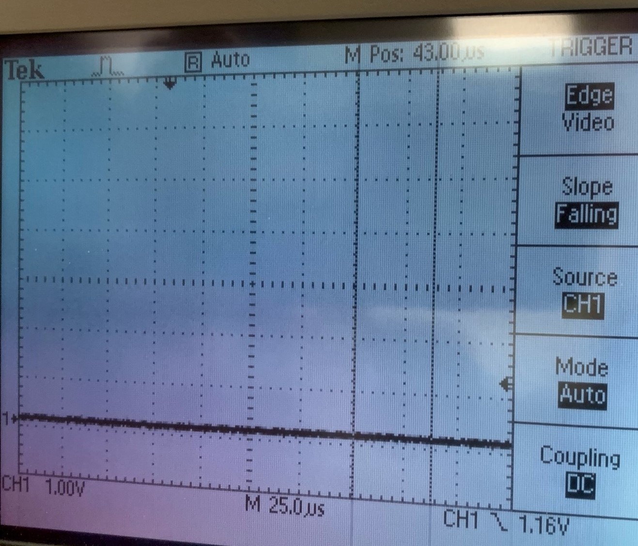

    Figure 3: nominal VOUT when EN pulled low:

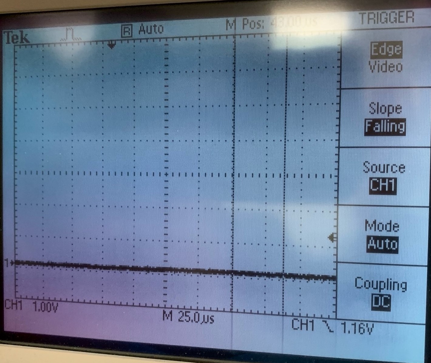

    Figure 4: VIN during issue event:

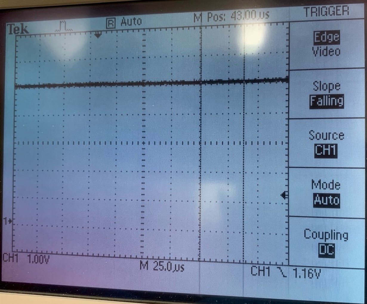

    Figure 5: EN pin during issue event:
