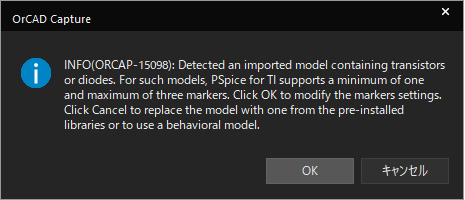

When I replace the LMG3410R150 in that circuit with the LMG3410R050 model, I get the following error:
(question 1)
What is a marker?
(Question 2)
What should I do to change the marker settings?
(Question 3)
Can the LMG3410R050 be used in the sample circuit?
  • Hello Kaji,
    Thanks for contacting us! Regarding the questions:
    1. Marker is probe. It could be current or voltage probe.
    2. You can add a voltage probe. However, the total number of probes should be less than 3.
    3. Yes, it should be able to be used in the circuit. If you could adjust your probe and simulate it again. It you still encounter problems, we can look into it for you.
