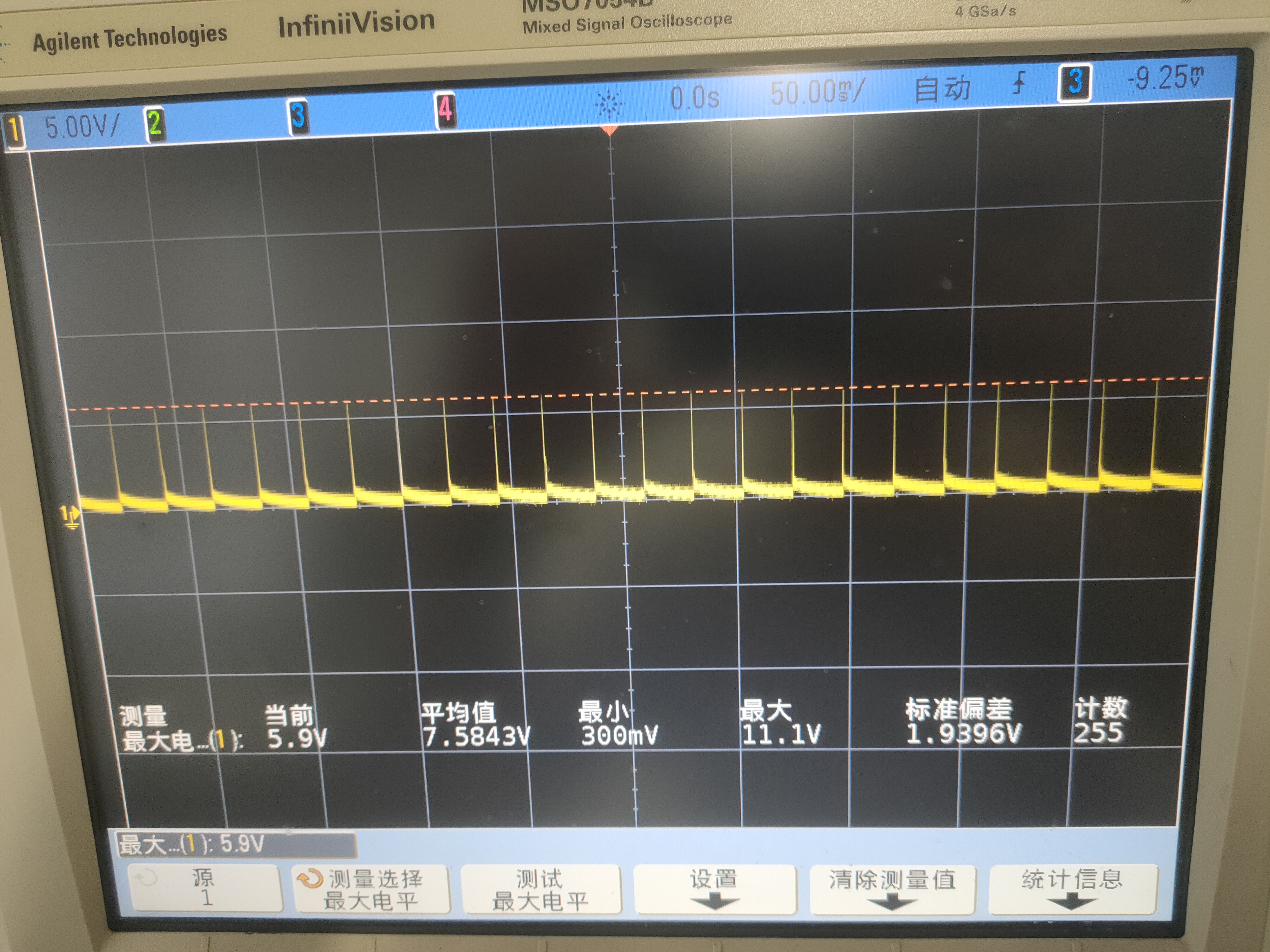

During customer's OVP test, they found that the OVP_GATE pin will be oscillation under below conditions, do you know what's the problem in here?
a. Set OVP threshold to 11V, OVP MOSFET will shutdown at ~10.94V.
b. When decreasing VAC voltage to ~10.8V, we will see OVP_GATE pin oscillation like below waveform.
c. When continue to decreasing VAC voltage to below 10.5V, it recovers to normal.

    Regarding VAC_OVP, the reaction time is measured from VAC trip point to SWx pin stop switching.  The scope shot above shows a part of the pulldown duration spec, which is a function FET gate capacitance.
    Regarding OVP_GATE ringing, the ringing is likely due to ringing on VAC around the trip point.  This will happen, especially if there are long inductive and/or resistive leads/traces from the power supply to the VAC pin, because the converter abruptly stops current flow, which is results in jump at VAC pin voltage.  In a real application, not a bench test setup, there will be lower inductance and there less of a chance of this ringing.  We will look into adding more hysteresis to our next device.

    To add on to Jeff's comment regarding question 1), Section 8.4.1.1 in the datasheet provides more details on how tvac_ovp is measured.
    tvac_ovp refers to the reaction time between VAC > VACOVP and OVPGATE starting to turn off. The actual time it takes to turn OVPGATE fully off depends on the FET gate capacitance and is not included in tvac_ovp.
