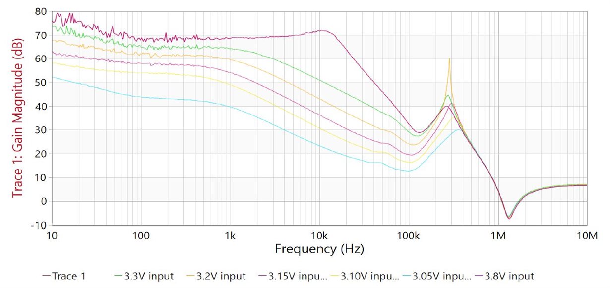

  • Hi Zack,
    I located the TPS793 EVM but it had the 2.8V option installed.  That is okay because for our testing we are only focused on the headroom.  So 3.8V input and 2.8V output will give similar results to 5.75V input and 4.75V output, etc.  Focus on the headroom voltage for how it applies to your 4.75V output version.
    For the tests there was already a 4.7uF output capacitor on the EVM, so all I had to do was add a 26.5 ohm resistor to obtain roughly 100mA load.
    I plotted PSRR values for the following input voltages: 3.8V, 3.3V, 3.2V, 3.15V, 3.10V and 3.05V.
    These results correspond to the following headroom values: 1V, 500mV, 400mV, 350mV, 300mV and 250mV.
    There is a legend at the bottom but basically, the higher the headroom the higher the PSRR.
    You can ignore the "Trace 1" trace, that is the same as the 3.8V input measurement.
    - Stephen
  • Thank you so much Stephen.
    This clearly illustrates the issue I am seeing.  I will try to see what I can do going forward;  Perhaps I can use a higher voltage rail in the next spin of my CCA.
