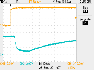

  • Hi Renato,
    Please share the scopeshot if you have it as it will help us understand the situation better. With 681Ohm I think the CL is around 3.5A.
    My initial suspicions for turn on failure is that inrush current is clamped by the device and then the current drops.
    For turn off, I suspect the same as you. The device is seeing an open load and I think if you could turn off TPS27S100 first and then turn off ULN2003A the FLT will not be reported.

    Here are the scopeshots.
    Unlucky, I'm using a two channel scope, so I must post two images.
    In the first, you can see the TPS27S100A command (EN, pin 3) in yellow and the VOUT (pin 5,6,7) in green.
    In the second, you can see the TPS27S100A command (EN, pin 3) in yellow and the /FLT out signal (pin 14) in green.
    Using 861 Ohm resistor on ILIM, the second image becomes as follows:
    I would like to turn-off ULN2003 some time after TPS27S100A, but it is not so simple to realize in my actual board.
    But this is only a prototype board, so I think I could do this when remastering the board.
