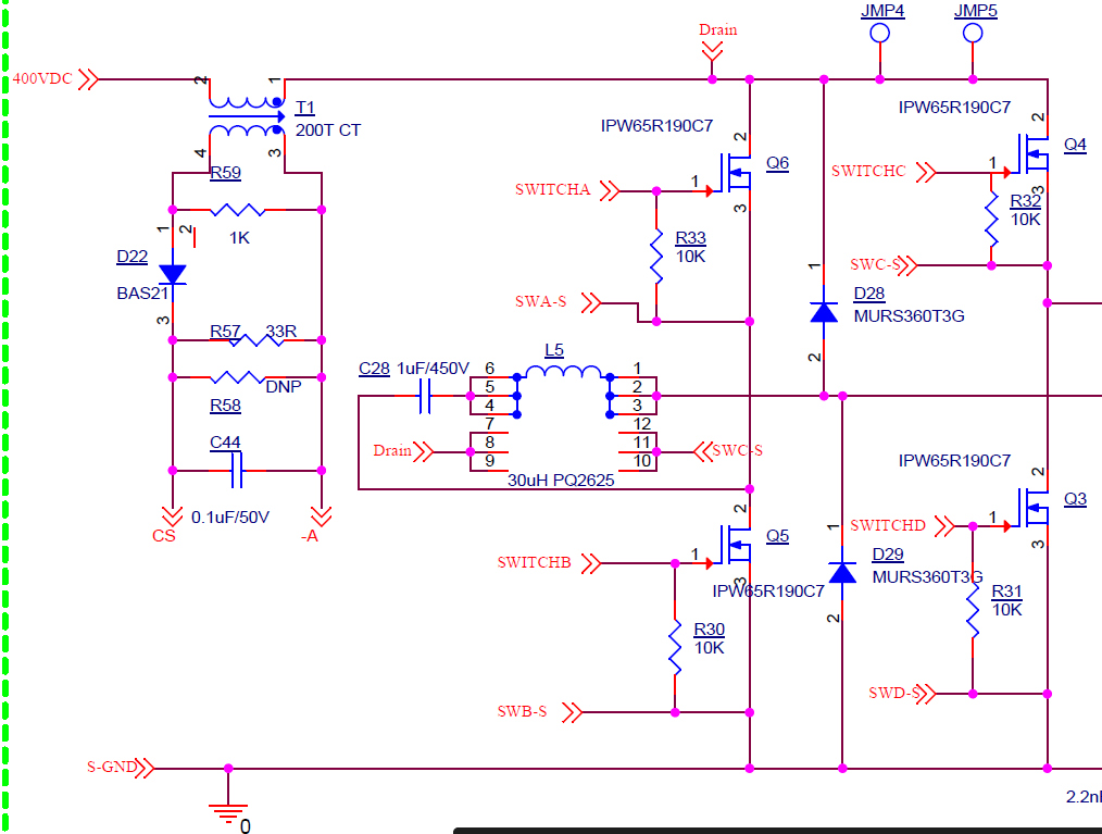

Dear TI experts,
I have designed a DC-DC converter with UCC28950
My input/output specifications are
Vin=400V
Vout=60V
Iout=17A
I have used 30uH shim inductor initially and  the power supply was working fine, but i was loosing some duty cycle, so i changed the inductor value to 10uH. Now my catch diode(D29) is failing.
What is the impact of reducing Shim inductor(L5) value in catch diode D29 in my schematic?
Aneesh
Aneesh
    Lshim has the energy that is used to achieve ZVS.  So reducing that will affect how you will achieve ZVS there will be less energy stored in it.
    I would not think reducing it would cause D29 to be damaged.  Are you shore this is what damaged that diode?
    Diode 29 and Diode 28 are uses to clamp the difference between the current in L5 and the primary of the transformer when you come out of freewheeling.
    What current level did you pick for the diodes?  They might just be under rated for current or dv/dt.  I would size the clamp diode for the maximum primary peak current just to be safe and use ultra fast diodes.
