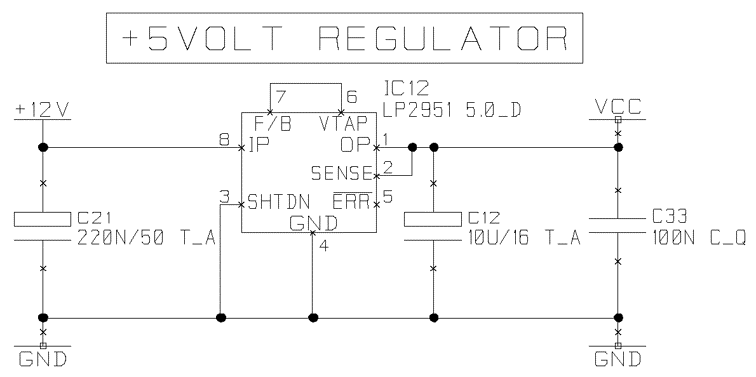

The LP2951 is dropping +12V to +5V0 whilst supplying approximately 65mA. I’ve measured the temperature on top of the package with a K-type thermocouple and the temperature is around 72Deg C. This is at an ambient of about 22Deg C in our office. The board is 4 layer (with internal GND and Power planes) and the LP2951 routing is reasonable. See below for part of our schematic.

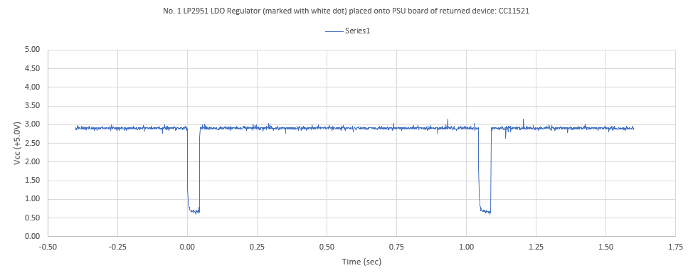

I set our oscilloscope to trigger on a Vcc downward excursion and include the following waveform. See below for the waveform data.
Note that the record length is 5sec. The lowest visible spike is about 3.50V and approx. 5ms wide.

  1. Is 72Deg C typical of what you would expect to measure on the top of the IC for 12V to 5V0 regulation @65mA, ambient being around 22Deg C? I’m wondering if this part is running too hot as it feels very hot to the touch?
  2. Are my oscilloscope traces showing the thermal shutdown mode in operation, or are we seeing another phenomenon?

    Using the datasheet thermal metrics for the D package, I calculate the junction temperature rise due to power dissipation to be 44C. With an ambient temperature of 70C, the virtual junction temperature would be 114C. This is well within specs, as the actual thermal shutdown temperature is normally above 150C , and it is typical for it to be around 170C for many parts. So to me, this does not seem like a junction temperature violation. Furthermore, the scope shot does not show thermal shutdown. During thermal shutdown the output voltage and load current typically head towards zero. If the thermal shutdown is prolonged, the output voltage and load current will both stay near zero, and you would not see prolonged shallow valleys like you are seeing.
    Have you monitored the 12V rail when this even is happening? I do not know why this would be happening if the 12V rail is behaving normally.

    Unfortunately, I haven't been able to get the first board back up and running again. I established all of the pin connections of the part to the correct nets (there were only 3 missing pads) and turned it on, but it is not now producing the correct output voltage. I think that the part may be damaged. It produced an output of 4.3V with a regular drop to 0.6V for 40ms in approx 1 sec intervals. I could not get anything else out of it, even after re-working all of the the joints.
    Next, I removed the part and put it into a known good board where this new board's LP2951 regulator had just been removed. It then produced an output of 2.9V, with similar mark-space?? (See attached diagram). Hopefully, this might make some sense to you? I have written this part off as being damaged and now will concentrate on other returned devices. (I stupidly forgot to record the 12V0 supply to this part whilst it was doing this, but it was a healthy 12V0).
    We have received one more device back from site and I set about heating the part up and checking the 5V0. This part was heated to 90Deg C and this didn't produce any errors on the output. We now have had 3 devices returned and only one has shown this output voltage error (at 60Deg C), and this just happened to be the first one I looked at.
    I'm convinced that we are not seeing Thermal Shutdown in operation and really that was what I had wanted to know. The other IC manufacturer has confirmed that a short duration drop to 2V5 would cause the effect that we see in our site failures. So, I will continue my search!
