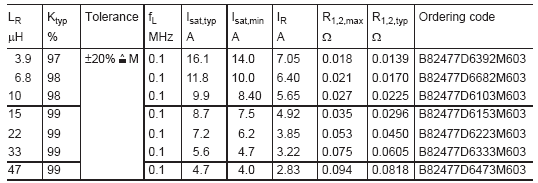

    2. Customers want advice on selecting power inductors.
        Specifications shown in WBDesign for L-value selection are as follows.
    TDK Coil is being selected, please recommend it.
    b82477d6.pdf
    1. Y cap is used cut high frequency noise in transformer. For noise reduction in PGND and AGND, please make sure to separate them in the PCB design with a single point connection.
    2. The 3.9uH one might be a little overkill based on Webench recommendation. But it should be fine.
