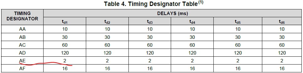

The figure shows LM3880MF-1AE is 30 ms delay.
But table 4 shows 30ms is AB, not AE.
Could you help to check the waveform shows wrong ?
The other questions is we would like to set the time period less than 2ms.
The datasheet shows min is 2ms. So is it better to choose LM3881 ?
  • Hi
    Thank you for the pointing out the typo. we had submitted the ticket to have the figure updated. The waveform is correct but the caption has wrong part number listed.
    LM3881 can support <2ms delay.
