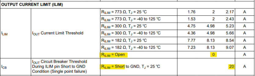

  • Hi Antonio,
    The single point failure protection of TPS25980 mentioned in datasheet is regarding the current limit functionality of the IC. The device still limits current even when the ILIM pin is OPEN or SHORTED.
    Do let us know if you have any question regarding the protection feature of the IC.
