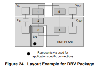

Dear TI Team
I would like to ask about TPS76333DRVR.
The NC pin is connected to the GND plane as shown in the figure below.
Is this to improve heat dissipation characteristics?

Hello Y.Ottey,
Yes, connecting the NC pin to ground is to improve the heat dissipation of the device.
