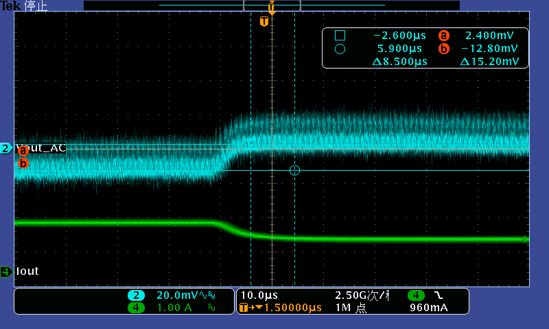

I have test the TPS543620 on its EVM and the test conditions are:
Vin=7.5V, fsw=1MHz, Vout=0.85V, Iout=1.4A to 2.7A(2.1A/us) or 1.4A to 0.9A(2.8A/us), Cout=22uF+15uF, Mode resister=27kOhm, resister divider is 3.6kOhm(top)&5.1kOhm(bottom).
Please refer to the below waveforms. It's obvious that the transient time is too  long, but I'm not sure what's wrong. Could you help me solve it? Many thanks!
    What do you mean by "the transient time is too long" ?
    Do you mean that the transition time of the load-step you are trying to create is taking too long?
    Load step-up right is now taking about 10us and step-down about 5us.
    Or do you mean that the recovery in the output voltage after a load-change is taking too long (still -40mV in the load-step after >50us) ?
  • Hi Yuting,
    One question to add onto Peter's. Where are you measuring Vout and how are your applying the load transient?
    I am guessing that you are referring to the settling time in the Vout after the load step. If I am right, I wonder if the issue is the Vout is being probed relatively far from the TPS543620's FB sense point. DC drops between the TPS543620 sense point and the Vout probe point would cause the behavior you are seeing.

  • Hi Peter, Anthony,
    Thanks  for your quick response.
    We have found the cause that there is DC drop between PGND_EFF_U1 and PGND since this trace is too narrow.
    I'm a rotator at Hollis's team and Hollis is my mentor. Many thanks for your support!

    Robin,
    Very glad we could help you find the cause of the problem so quickly.  Best of luck.
