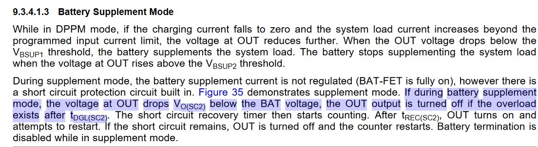

I am having an issue where the VBATT to VOUT voltage difference is greater than 200mV when only outputting 3A. On some devices this registers as a short circuit and the output is shutoff. This IC should be capable of outputting 4.5A. The device has pulsed loads of 8.2W for up to 10ms. This does result in substantial voltage droop from the battery (as low as 2.7V) but the battery and the rest of the system were designed with this in mind.
Does a lower voltage at the VBATT pins result in a larger dropout voltage?

    Yes, this can be the case. As shown, the voltage dropout can be 50mV typically to 100mV max at 1A current output. At 3A, this would result in a max of 300mV drop. With a battery very depleted, this can cause the output to drop and the device's short circuit protection to trip.
    As you mentioned, the device is capable of outputting 4.5A but this is only true if the battery is able to output the supplemental current. The BQ24075 is limited  to an input current of 1.6A in the condition that:
    Input Current = Output current + Charge Current
    Otherwise, the device is going to go into supplement mode where the battery supplements the battery current.
    With a depleted battery, as you've mentioned, this can trigger the output shutoff as shown here:
    If the device is operating in battery only mode, then the high current draw can still cause the output to drop (as the voltage is not sufficient to supply the necessary current) and result in a shutoff.
    In short, a lower battery voltage with a large current draw can cause the device the device to shutoff due to a high dropout voltage.

    In my scenario the system is running entirely from battery power. Section 9.3.4.2 says that short circuit is detected if VBAT - VOUT > 250mV (this is actually between 200mV and 300mV min/max), but considering that section 8.3 specifies IBAT (discharge) as 4.5A it seems strange to me that a short circuit would be detected at less than that. The margin on short circuit detection and valid operation seems to be non-existent. If the dropout voltage can be as high as 100mV with 1A and a short circuit can be detected at as low as 200mV, then even if my battery voltage was good it would still have a chance of cutting out at 2A.
    If 4.5A is only capable in supplement mode and battery current is actually limited to 2.9A then the highlighted line is quite misleading.
    Are there any pin compatible parts that do not have the short circuit detection, have it set higher, or have lower dropout?

    The 4.5A is the battery output max, which is not necessarily supplement mode. In a battery only mode, the current from the battery to the output is not regulated and so the limitations of the current draw is whether or not the battery is able to sufficiently provide the power draw. Do you see this issue at higher battery voltages?
