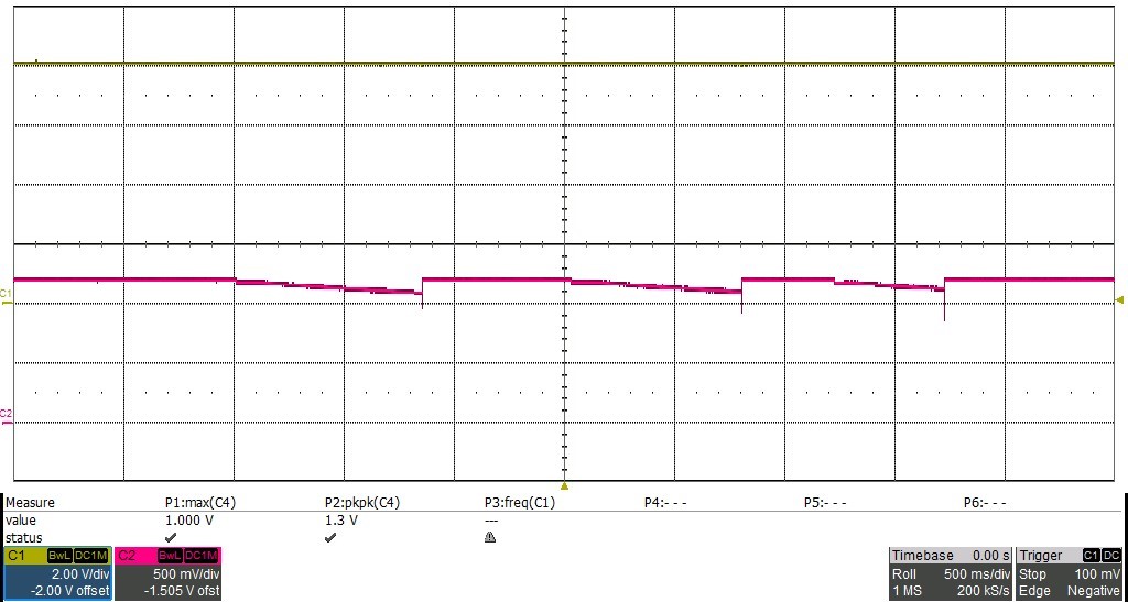

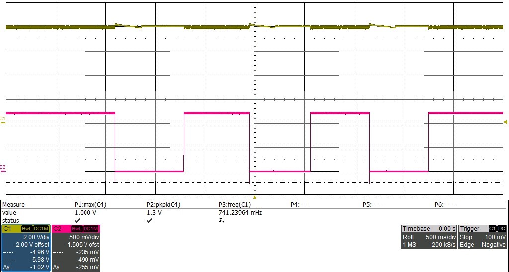

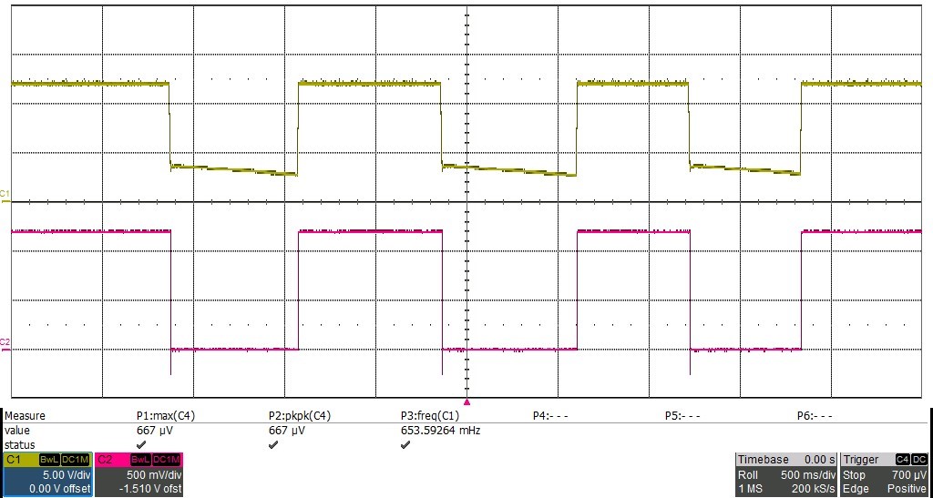

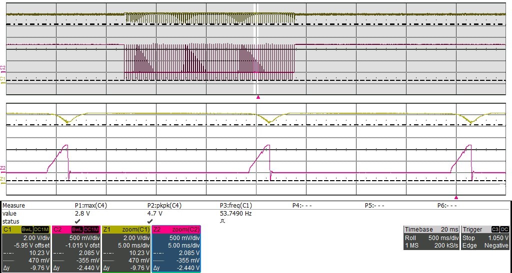

My customer tested the TPS40322 EVM and found there has a negative voltage of about -250mV in the following test item.
1. OLP test, C1(yellow): Vin, 12Vdc, C2(red): Vout, used a short probe to test TP7 & TP22, found output voltage has a negative voltage
2. Vin ON/OFF test, C1(yellow): Vin, 12Vdc, C2(red): Vout, used a short probe to test TP7 & TP22, found output voltage has a negative voltage
3. EN ON/OFF test (output add Switch), C1 (yellow): Vin, 12Vdc, C2(red): Vout, used a probe test output terminal, found output voltage has a negative voltage
Load 0A
Load 30A
Are the above waveforms normal? thanks.
