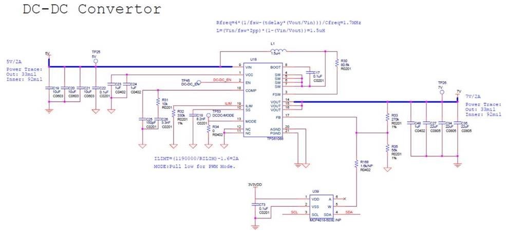

Hi Sir,
Here is schematic using TPS61088, do you have idea how can improve DC-DC efficiency?
Thanks, Ian.

Dear Sir,
You can improve the efficiency in the below way:
1. Use better inductor, with very low DCR and small core loss;
2. Use low operation frequency, setting the frequency at fsw=400kHz can achieve higher efficiency than with fsw= 600kHz or even higher frequency;
3. Use 4-layer pcb with big GND copper plane can help the thermal hence better efficiency.
What is your Vin/Vo/Io?
Hi Helen,
Thanks for advise.
Vin 5V
Vout 7V
Iout 1A
Currently we get about 90% efficiency.
Thanks, Ian.
Hi Ivan,
If you choose a low operation frequency, the efficiency can be higher than 92-93%.
