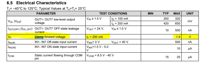

  • Dimitri-san,
    Thank you for your reply.
    Conditions: COM = 8.5V / OUTx = 40V
    I found that it doesn't work under the above conditions.
    Where is it listed prerequisite of COM and OUTx in the datasheet?
    Initially, I decided that it would work with the following datasheet content:
    Ishiwata
  • Ishiwata-san,
    Section 6.3 shows the full possible range of each , but
    , that doesn't mean that VOUT (max) used with Vcom (min) condition will work.
    VF of the internal EMF clamp diode is 1.4V max.
    You do not want this diode to become forward biased during normal operation, and you want it to be able to shunt away current during inductive kickback such as for motor driving applications. You also do not want to place supplies across the clamp diode that are greater than VF as it will instantly destroy the device.
    For this reason, VCOM should be kept EQUAL to VSUP. if you kept COM pin voltage at 8.5V and applied VSUP of 40V, the device would pop and make burning smells.
