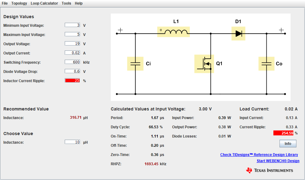

Please see 8.2.3 Li-Ion Driver for 6 White LEDs in datasheet. Input voltage is 3V to 5V. Inductance is 10uH. Io=20mA. Vo=19V.
According to the calculating results in following picture, the ripple current of inductor is 0.33A, which is larger than 2*0.13A. So the circuit works at DCM mode in this situation.
However, the input current in fig. 26 is continuous. Why?

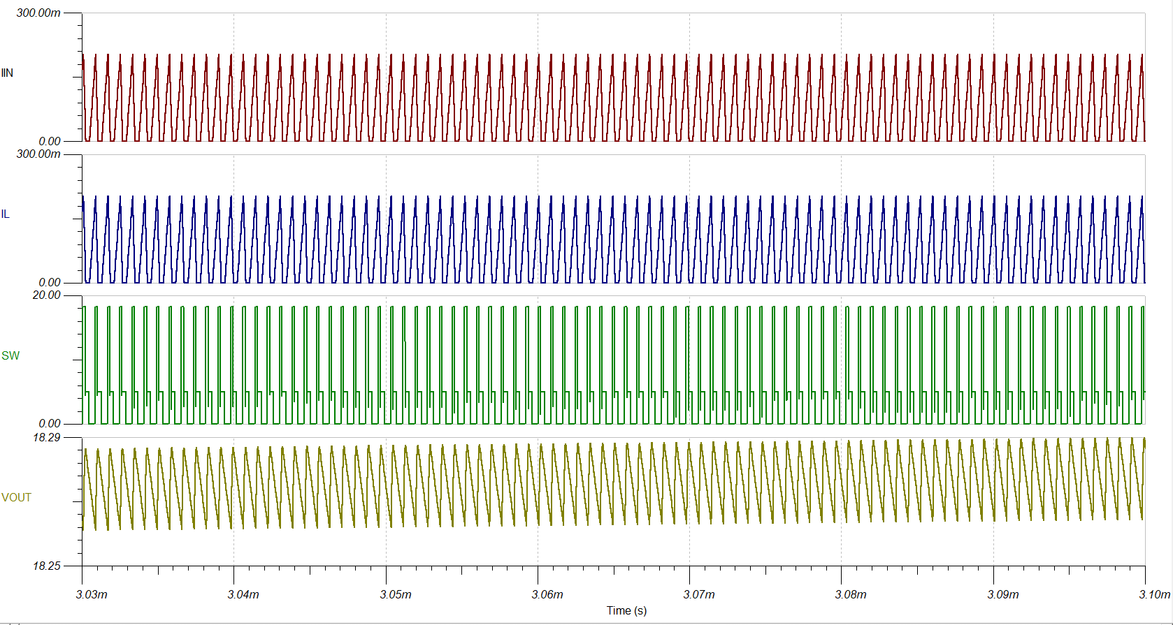

  • Hi Naizeng,
    For actual application, there is parasitic inductance and resistance from power supply to input of device, combined with Cin, input current is filtered. To furtherly verify the result, I have a simulation. The first one is without parasitic inductance and resistance, and the second one is w/ parasitic inductance and resistance.
