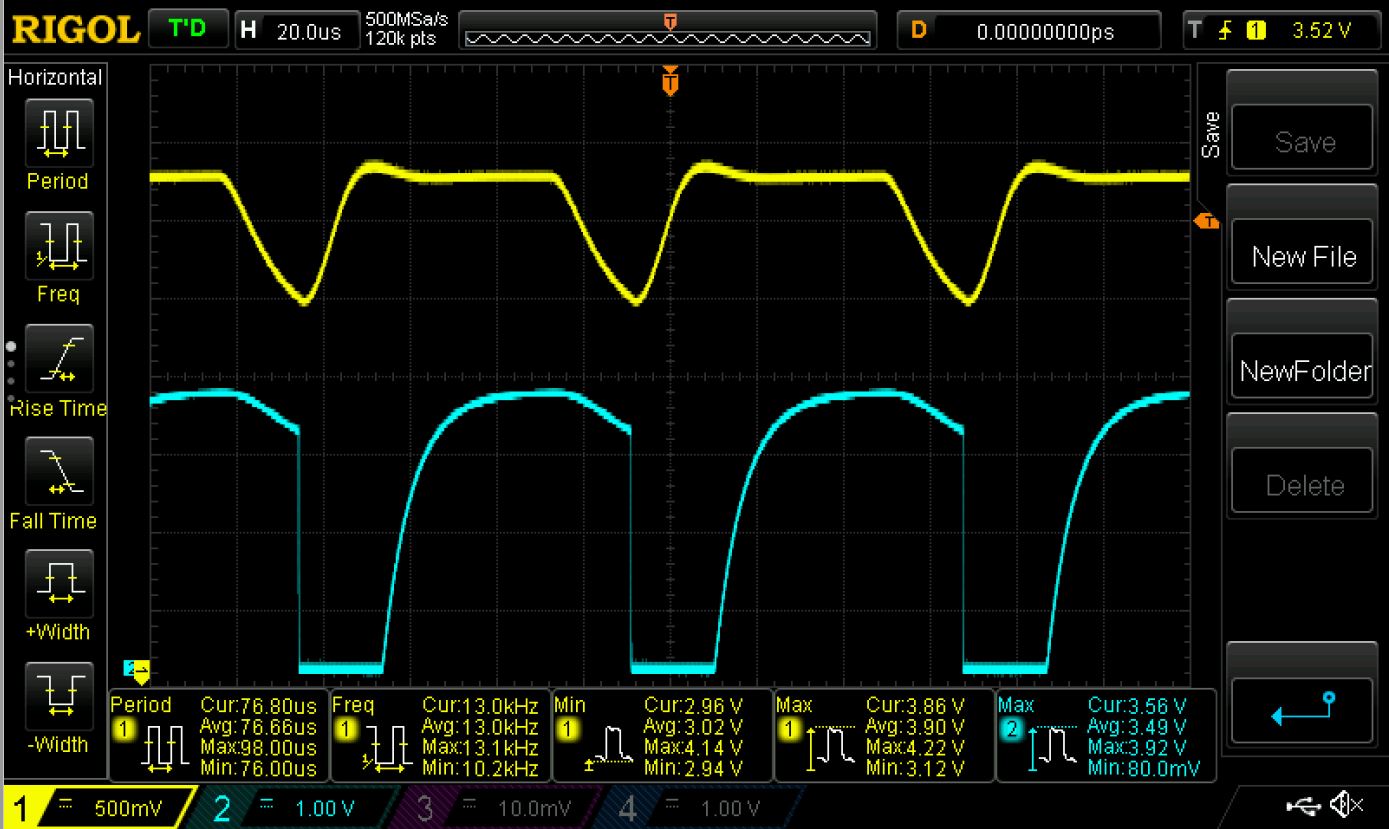

The yellow channel indicates the VBat waveform and the blue one indicates the En waveform. It is apparent that there is a dip in both the waveforms when a 1 A load is attached at 3.7V causing an irregular supply to the load. Can this be avoided at all so that the TPS61030 enable pin triggers an entire shutdown at 3.2V limiting the output voltage to zero volts???
  • Hi Ibrahim,

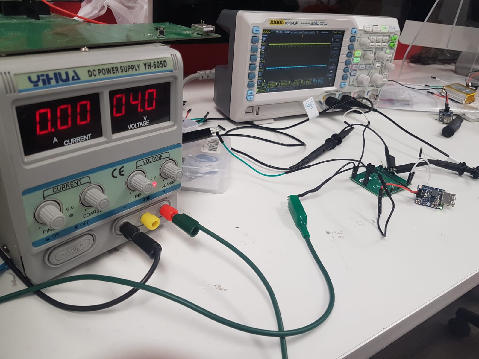

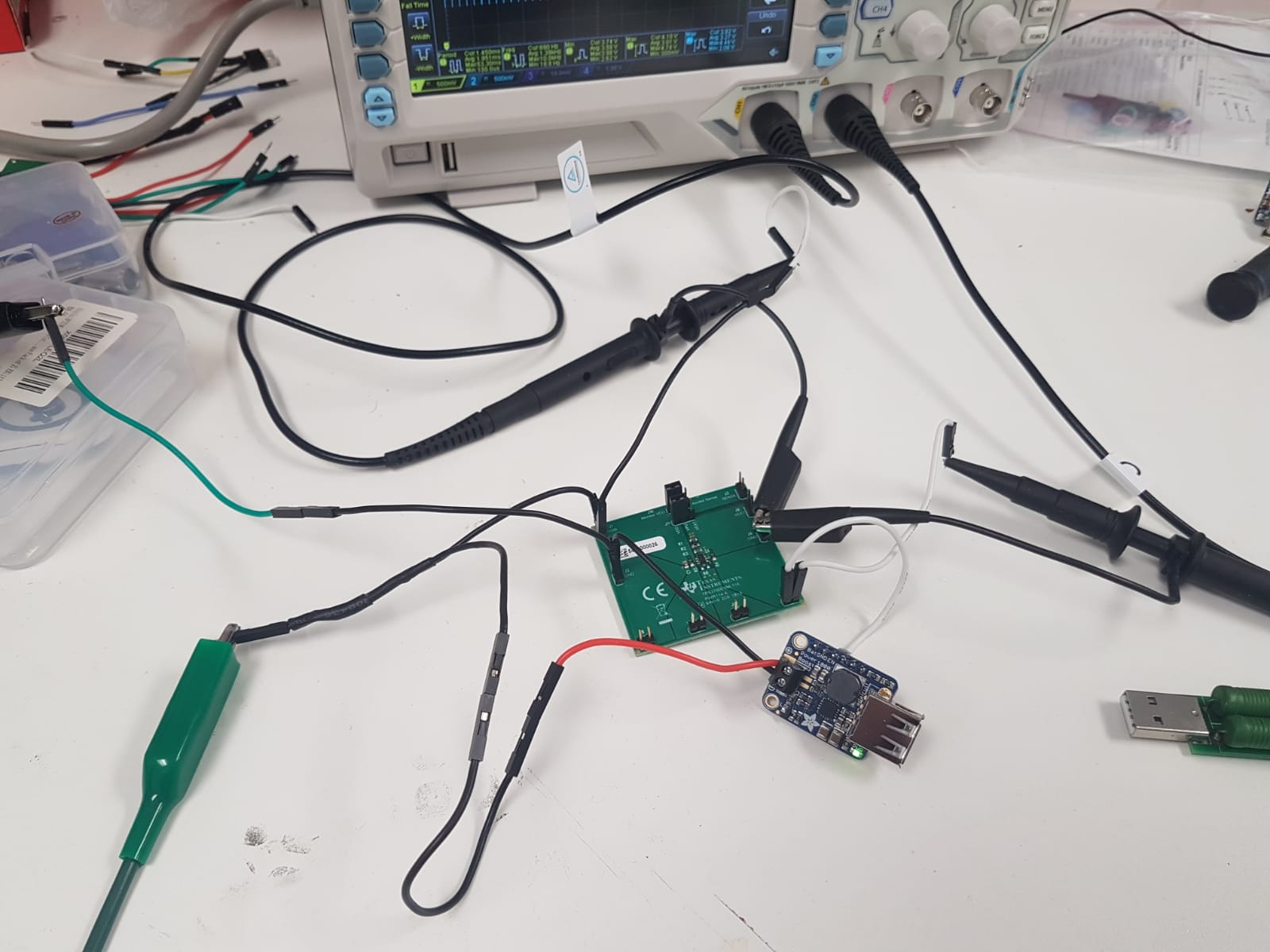

    Why is you VBat waveform not stable, even when there is no load? Is VBat the real supply voltage on your EVM? As I mentioned before, the comparator should trigger EN pin to low when VBat is 3.2V. And the voltage of your power supply could be higher since there is resistance on the cable. To make the showed voltage on your power supply is exactly the voltage on EVM, you can use 4 wires to connect. You need additional 2 wires used as sense wire connecting sense pins on EVM. Could you give me a picture of your bench setup including power supply? You can draw a block diagram as well to let me know how you connect power supply and your EVMs. It is strange that your VBat waveform not stable.
    Yichen
  • Hi Ibrahim,
    These pictures below shows what 4 wire connection is. There are 2 sense wires connecting power supply and EVM which can make sure the real input voltage is the same as setting value on screen of power supply. You can add a capacitor between the red wire and yellow wire if it is unstable.

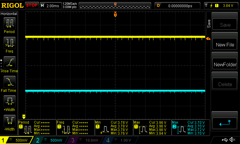

    Yes VBat is the real supply voltage of my EVM, and I'm not sure why the waveforms are so unstable. All the images sent were tests done with a YH-605D DC power supply and there were projects in the past which showed that this supply is not the most stable. So I have attached a waveform image with an actual 6000 mah battery whose capacity indicates a voltage level 3.9V:
    Mind you that this is for a battery at a voltage far from the threshold. I suspect that as the capacity of the battery drains, the influence of the enable pin may take effect on the stability of the voltage source.
    Images of my test bench supply as well as a rough block diagram are attached below here:
    Thanks as always,
    Ibrahim
  • Hi Ibrahim,
    One possible reason for unstable VBat is that TPS61030 works in PSM and the current pulse is high and discontinuous. Due to internal resistance of your battery, the output voltage will decrease when there is an inrush current and increase back when the current is zero. You can check the current waveform if you have current probe. If not, you can set SYNC pin to high and disable PSM to see if there are any differences. And you can use TPS61030 alone first to avoid the influence of comparator.
    If the internal resistance of your power supply is low enough, the power supply voltage should be stable. Please set the current limit of your power supply to maximum and use only TPS61030.
    Yichen

  • Hi Ibrahim,
    From your waveforms it is obvious that the TPS61030 is working normally. It works in PSM without load and PWM with load. And VBat is stable with load, the internal resistance of your power supply is large so there is a obvious voltage drop when inrush current occurs in PSM.
    You can not solder SYNC pin to my VBat since it will cause shorting.
    Please check the waveforms of VBat, 5V Vout and EN when both comparator and boost are connecting to power supply, but the EN pin is not connected to VOUTA.

  • Hi Ibrahim,
    Sorry, my mistake. I should say VOUTA without connecting to EN pin. I want to know if comparator can work well when EN and VOUTA are not connected. If not, we should focus on comparator. From previous waveforms we know Boost works well without comparator, and we need to find the reason of this strange waveform:
    And put a large capacitor with low ESR may be helpful for battery input, which could make VBat stable. Besides, you can make base line of your CH1 higher so I can find the value better. These Avg, Max, Min are not always accurate.
