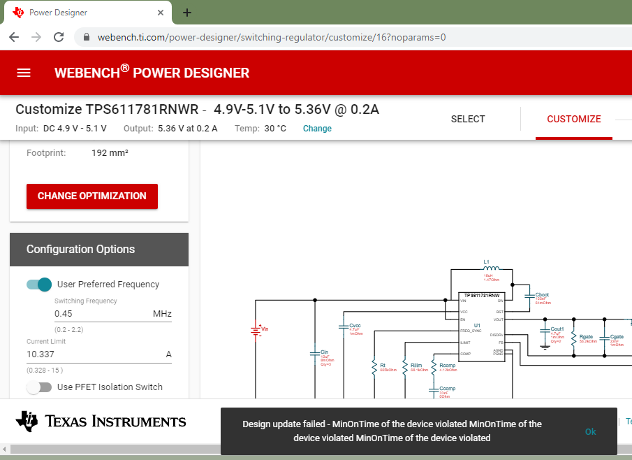

I saw a related question regarding Vout close to Vin.  In my situation I have Vin = (4.9 to 5.1), Vout = 5.36 @ 200 mA.  Will TPS61178 versus TPS611781 cause different results in Vout?
We originally wanted TPS61178 but this was out of stock so ordered the TPS611781.  A colleague reports abnormally high Vout  (about 5.9) and the FB pin is at 1.32V on one board.....not debugged yet.  Normally if violating minimum on time (with many boost ICs) I would expect pulse skipping but perhaps this device cannot do that (??)
Similarly; should I expect any impact in Vout (with minimum pulse width violation) if the TPS61178 or TPS611781 is synchronized to an external clock?

    The TPS611781 has the fixed switching frequency and no PFM.
    But actually, both TPS61178 or TPS611781 can supply 5.36/2A with Vin from 4.9-5.1:
    1. For tps61178, it has the PFM, so it will skips some pulses when Vin is too close to Vout to regulate the Vout to the target.
    2, For TPS611781, the min Toff may cause the Vout higher than the target when Vin is too close the Vout. But you can set the switching frequency much lower to avoid such condition.

    For the TPS61178, I have checked in my lab, the Vout can regulate to the target well when Vin is close to Vout. With or without external clock. The converter mainly operate in the PFM mode with light load.
    Would you share the waveform in your side? When you find Vout=5.9V not the 5.1V. Including the Vin, Vout, SW, and Vfb.

    Firstly, please let me confirm that TPS611781 is the forced PWM device, while TPS61178 is auto PFM device.
    Then, TPS61178 can regulate the Vout even Vin is close to it, but the ripple will be larger than typical cases.
    It can trigger the min Toff, and then the Vout will larger than target. But once the converter detect the Vout higher than target, it will skip some pulse to wait Vout drops to normal. Both internal clock or external clock.
