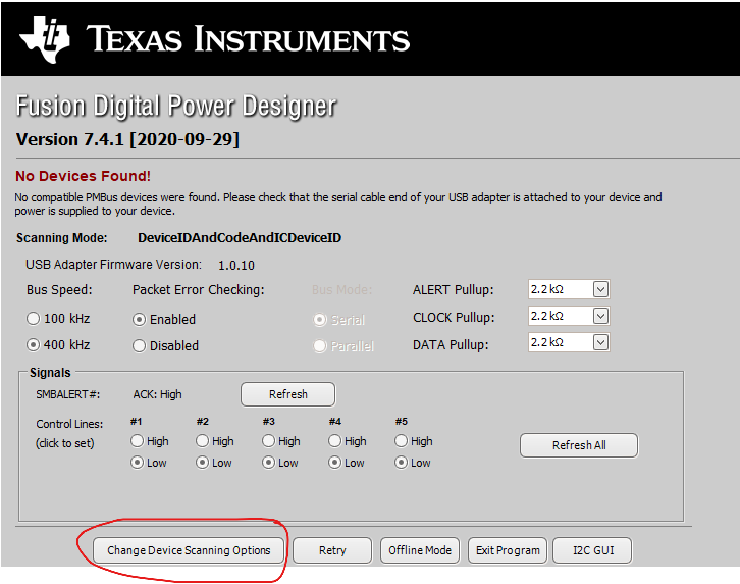

    Are you seeing this after launching the TI FUSION Digital Power Designer software?
    It is likely that you are seeing a manifestation of the FUSION's "Address Scan" process interacting with the TPS544B25.
    In order to identify connected devices that use different methods of digital discovery, the FUSION software "scans" the connected bus by reading from several I2C registers / PMBus command codes at each PMBus Address.  The TPS544B25 uses the standard IC_DEVICE_ID command code, but does not support the MFR_SPECIFIC_FD (Command Code FDh) and MFR_SPECIFIC_FE (Command Code FEh) commands that FUSION uses in the Scan.
    You can confirm this is the route of the issue by opening the FUSION software without the TPS544B25 connected.  In the "Device Not Detected" window, you can select "Change Device Scanning Options"

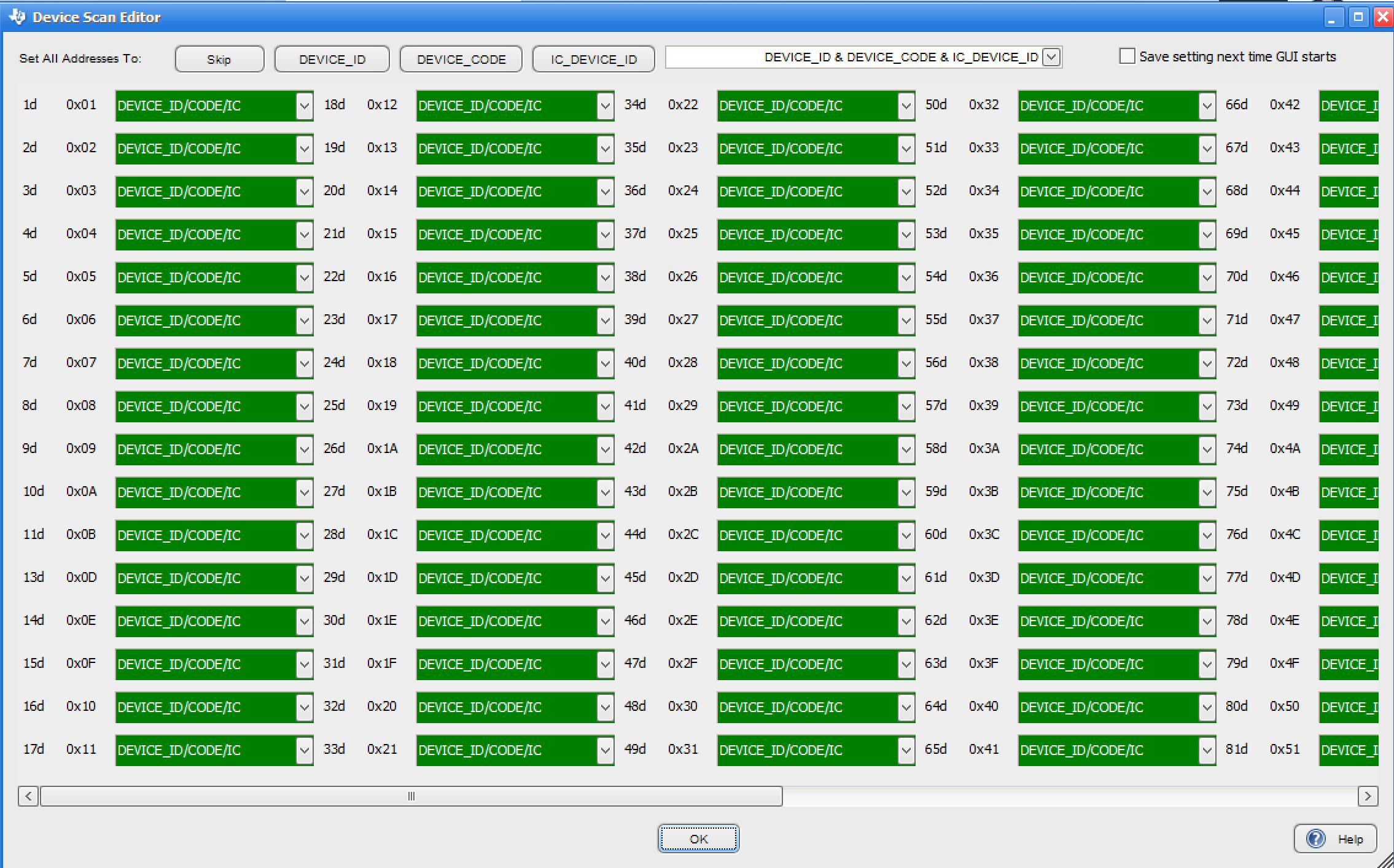

    This will bring up the "Scan Editor" which allows you to set the scanning options used for each device address.

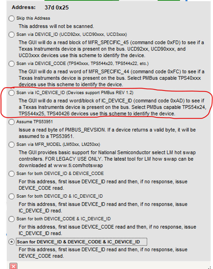

    You can change all of the addresses to use IC_DEVICE_ID (Command Code ADh) by selecting "IC_DEVICE_ID" on the top line, or you can update the specific address you are using to only use IC_DEVICE_ID, by selecting the pull-down menu and picking the IC_DEVICE_ID option
    If that eliminates the Invalid Command CML error you are seeing initially, it is a valid warning where the device is informing the system that it rejected a transaction because access to an unsupported command was requested as part of the scan.
