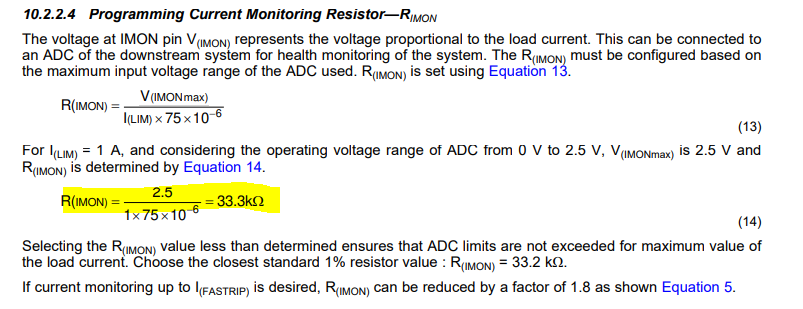

Customer use our calculation tool to calculate IMON resistor.
But the calculation result is different from the datasheet.
If l(LIM) is 1A, so R(IMON) is 33.3k, right?
I suggest him follow the datasheet first.
Many Thanks,
Jimmy
  • Hi Jimmy,
    78.28 μA/A is the typical current monitor gain as per EC table.
    Suggest to follow equation (14) and use 78.28 μA/A instead of 75 μA/A for the calculations. For 1A current limit, we get R(IMON) as 31.93k
