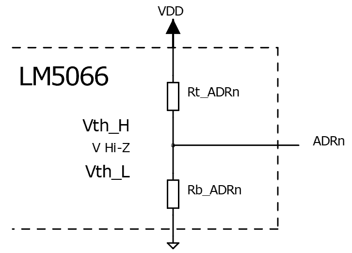

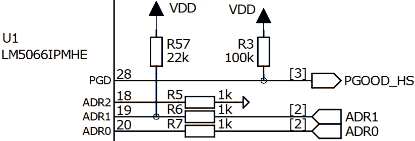

  • Hi Rakesh,
    The LM5066 datasheet clearly states that the address inputs should be connected to VDD, GND or left open. However, our experience so far shows that the input currents are negligible and our solution works in many similar places.
    For the clarity, I enclose a section of our schematic, as well as how the internal structure of the address input of the LM5066 system probably looks like.
    The information I asked about would allow us to determine what pullup and serial resistor values we can use to safely define the LM5066 address. The address (1 of 5)  is set on the other side of module connector.
    If this information is not available, please suggest the value of these resistors. Serial resistors are used mostly for security reasons.
    Best regards
    Michal Laszczynski
  • Hi Michal,
    Thanks for the details. I will check whether we have information available on the internal resistors or not and let you know early next week.
    On the external pull-up, we use standard 10kOhm resistor.
    Best Regards, Rakesh
  • Hi Michal,
    Sorry, we don't have details of internal pull-up and pull-down resistors. Please use external pull-up of standard 10kOhm resistor and let us know if you see any issues.
