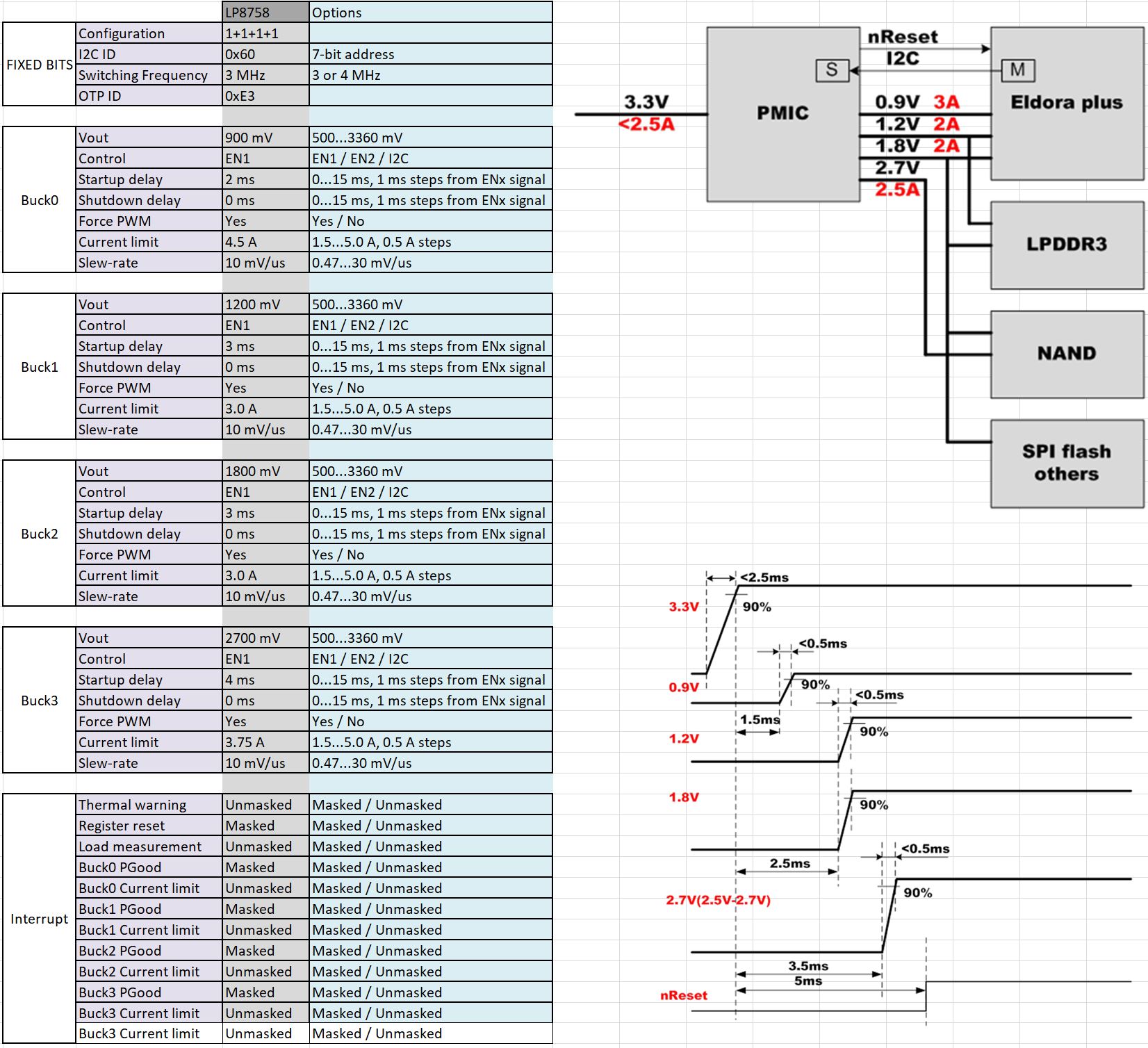

Dears
We need a PMIC to power supply Longson 2k1000.

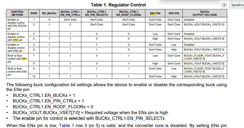

I found the LP8758-E3 is suitable choose. But I want to able and disable the EN1/EN2 with hardware control. May I add the load switch? How to achieve it? Which load switch I can choose?
For example, the 4 voltages at the output terminal need to have a time sequence. At the beginning, power on at 3.3v, then power on at 1.2v, power on at 1.5v, and power on at 0.9v, each with an interval of 10ms, how to control this at the input.
I don't want to use the software to control.
