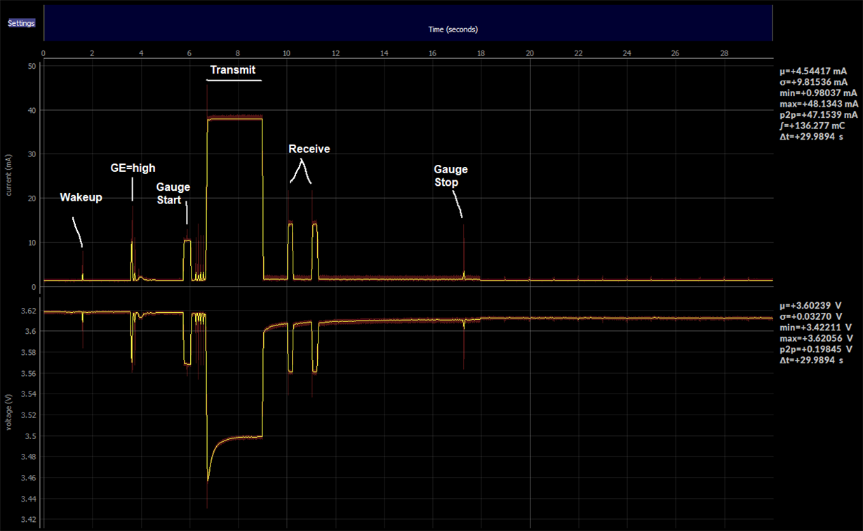

    Below you see the wake up, transmit and receive sequence which results in the SOH_MERIT error right after the Gauge Stop command.

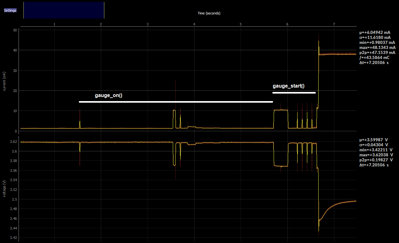

    When zoomed in on the GE=high and the Gauge Start command
    The two functions which are used to create this sequence are as follows:

    Can't the BQ35100 cope with the rise of the battery voltage when the MCU is in sleep? So during sleep the current consumption is lower and the voltage higher, than during a DelayMs().
    When I change the gauge_on() function slightly to:
    void gauge_on(void) {
        sleep(2000);
        DelayMs(50);
        GpioWrite(&gauge_GE, 1);
        DelayMs(100);
        /* Wait for bq35100 to initialize.*/
        DelayMs(2000);
    And so the MPU doesn't sleep after GE=high and during the initialization phase (INITCOMP=0). Now the BQ35100 not only reports a SOH_MERIT but also an EOS_BAD_OCV. The BQ35100 technical reference manual describes the EOS_BAD_OCV as: "Indicates the measured voltage exceeds the initial OCV voltage". But this was also the most common reason for the SOH_MERIT. Also replacing the sleep() function calls within gauge_start() also results in the EOS_BAD_OCV error.
    So sleeping after GE=high and during initialization seems to be good to prevent an EOS_BAD_OCV error.
    But the BQ35100 technical reference manual describes the SOH_MERIT as: "Indicates the quality of the SOH calculation was limited". So what could be happening here, and what is the less common cause of the SOH_MERIT error?

    If you look at the discharge profile of a measurement and transmit cycle during one of my tests, how should the profile look to prevent this issue?
    The uC wakes up to make GE=high and goes to sleep right after this. This causes a small discharge and a drop of the voltage of about 50mV. The voltage rises during the sleep state. About 2 second later the uC wakes up again, and so discharges the battery causing a voltage drop of again 50mV, and the "Gauge Start" is given. So between GE=High and "Gauge start" the voltage has risen, but not because the battery is not relaxed, but because of the wake-up and sleep of the uC. The voltage at GE=high is however about the same as at "Gauge Start". Does this voltage drop of 50mV influences the measurement causing the SOH_MERIT, or is the 50mV too small for this?
    Could the SOH_MERIT also be caused by the higher voltage level after "Gause start" and before transmit?
    Or has the profile up to "Gauge Stop" also influence on the SOH_MERIT?
    Is the BQ35100 in EOS mode capable of performing it's measurements when the uC is sleeping and waking up constantly causing the fluctuations on the measured voltage, or is the voltage drop too small too have influence, since it is not a discharge of 100mV minimum? Or does it only use the GE=high and "Gauge Start" as sampling moments?

  • Hello Wyatt,
    I have created a test setup using several evaluation boards to test all ins and outs of the final design before we have our own PCB produced. So it mimics the final application and the load profile of this final design. Currently this setup consists of the BQ35100EVM-795 plus a LoRaWAN module and some extra sensor boards, all powered by the battery and monitored by the BQ35100. The uC controls the LoRaWAN RF, the BQ35100 and the sensors, and places all in sleep or have them wake up.
    So the discharge pulse like in https://e2e.ti.com/support/power-management/f/196/p/963480/3563310#3563310 show the actual load of the application. And the main discharge pulse has a fairly constant current profile caused by the transmission of the data. But there are also other processes active, like the two receive cycles, and the wake-up/sleep cycles of the uC and the sensors.
    This setup should be running without issues to know the final application will run without this issue. Using an ideal constant current discharge pulse is not a valid evaluation.
    I will wait for your information. Please keep this thread open.
