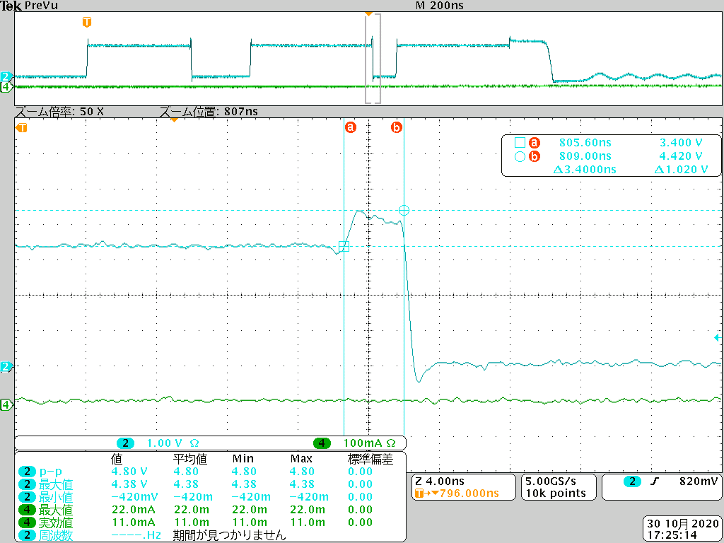

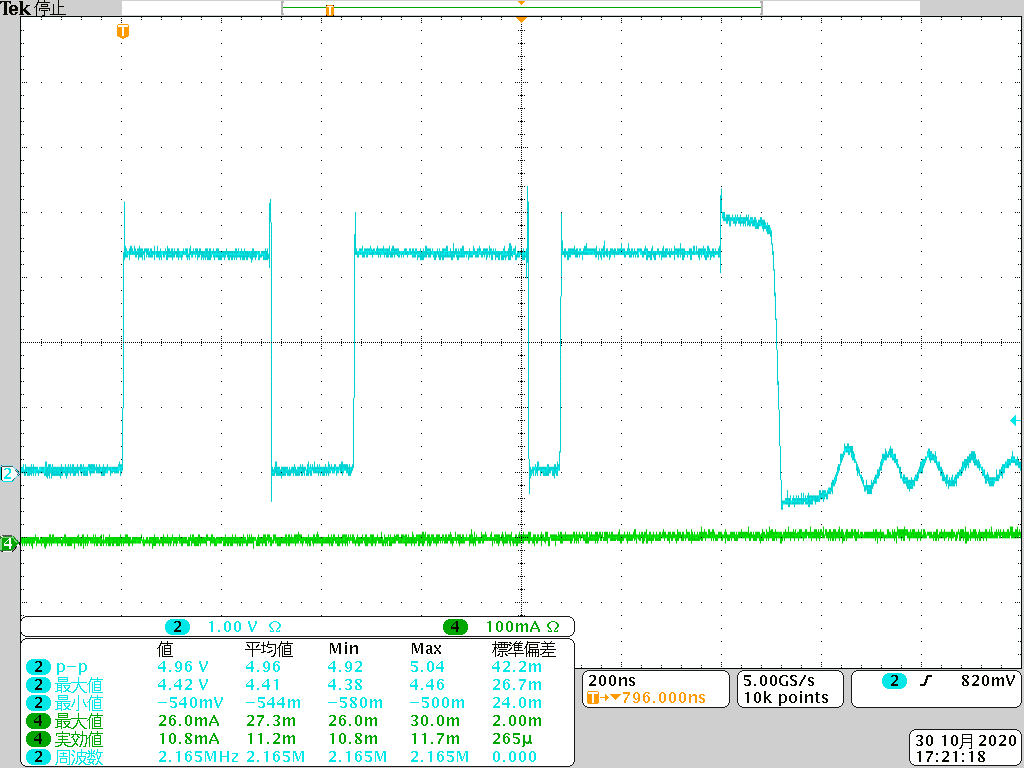

I measured the waveform of L2 pin in TPS63024.
I got the following waveform.
Is this waveform as expected? Is it right?
measure condition: Vin = 2.8V, Vo = 3.3V, Io = 10mA
 Mode = PFM
 L = 1uH, Co = 22uF x 2pcs + 10uF x 1pcs
