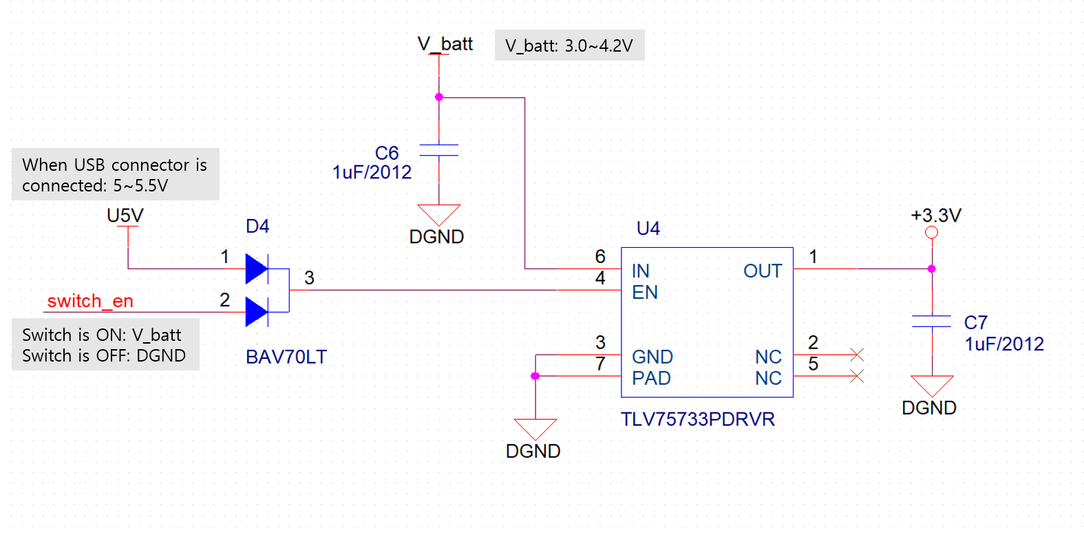

Hello.
There is a problem when EN pin voltage is higher than IN voltage.
Briefly describing my system, VIN is lipo battery(3.0~4.2V), VEN is connected to Vbatt(3.0~4.2V) or external usb power(about 5.0V).
TLV75733 works well usually. However the problem is occurred when usb power is connected to EN pin while the battery voltage is very low. It works well when the battery voltage is normal.
TLV75733 doesn't work until disconnecting VIN when this problem is occurred.
There is not mention in the datasheet. VEN should lower than VIN?
If you need more information of my circuit, please let me know.
Thanks in advance.

  • Hello.
    It needs more detailed explanation of my system.
    Lipo battery capacity is 2500mA, that's enough.
    There are 2 ways to enable regulator in my system.
    1) External usb power connection
    2) V_batt is connected to EN pin by internal circuit when physical switch is turned on.
    The regulator works well by both ways in normal situation.
    However the problem is occurred when the battery voltage is very low(3.0V or lower).
    1) The regulator is off state VIN(pin 6) is connected to V_batt(3.0V).
    2) I connect the usb power and EN(pin 4) pin rise 5V.
    3) Regulator does not work and it's stuck.
    4) Disconnecting usb power and turn on switch are not working
    5) It works again after I release battery from VIN(pin 6) and connect.
    This problem is occurred only when I use usb power. Enable by switch works well.
    What is the reason of this problem?

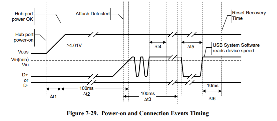

    I was able to find some information on powering your device from USB in a paper referenced in the Powering electronics from the USB port App Note. The Universal Serial Bus Specification Revision 2.0 document, on page 150 figure 7-29, shows how the USB port turns on and how the connection timing events look.
    It looks like the EN signal might actually toggle at a frequency higher than 10kHz, which the datasheet says, “If EN is driven to a higher voltage than VIN, limit the frequency on EN to below 10 kHz”.
    You could try adding an RC delay to the USB Enable connection if this does happen to be the case.
