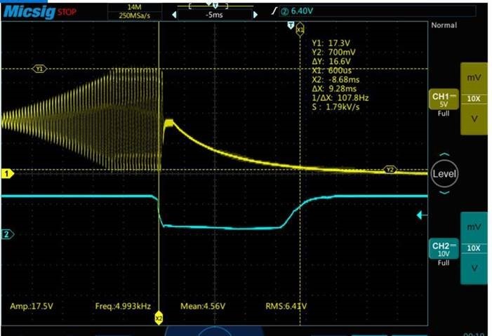

Hi Sir,
My customer using TPS23754 in Soundbar application.
PoE will stop when music is suddenly "LOUNDER", but average power not over 25W.
Soundbar average output power: ~4.6W , and ~64W peak (4A).
Here are waveform s below, CH1. Soundbar output   CH2. POE 12V,
Q:
It looks trigger TPS23754 protection? I'm not sure. If any way can avoid the issue?
Thanks, Ian.
  • Hey Ian,
    How long is the peak power for? The TPS23754 can only supply 25W of power - a higher power device is probably required.  I would recommend the TPS2373-4 in the PMP21318
