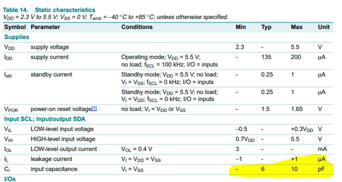

Hi Team,
A customer would like to know the capacitance of SCL and SDA lines of LM25066 similar to the datasheet below.
Danilo
