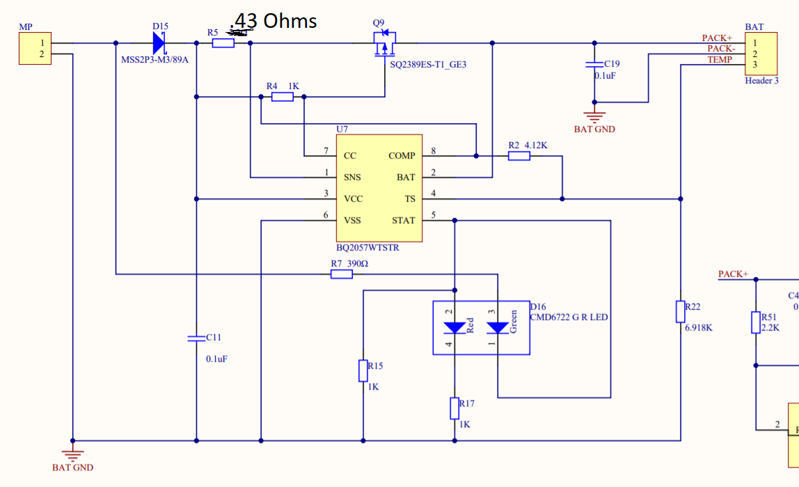

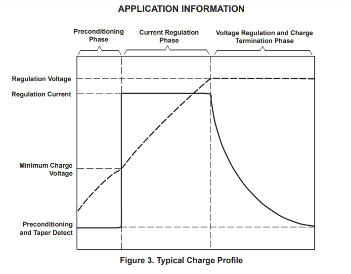

Or testing has shown a massive inrush of current when charging our batteries from cutoff voltages. This is not what the data sheet says should happen (Diagram 2). What are some possible causes of this/solutions? I am at a loss for how to fix it.
This circuit (Diagram 1) is taken directly from the data sheet. There is no thermistor hooked up to the pin instead it just has the voltage divider to keep the device on. Our goal is to use a 9.1V input to charge a 2s battery pack to 8.4V at a rate of ~400mA (~.5C).

Diagram 1
Diagram 2
