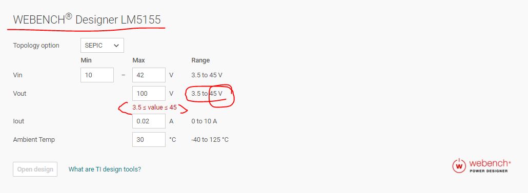

    The second question is that if you select LM5155 in WEBENCH and run WEBENCH, it comes out up to 45V in SEPIC structure. please check. ( My Vout spec is 100V )
    The WEBENCH address I ran is as below.
    www.ti.com/.../LM5155

    Regarding WEBENCH, it will not support the dual output application that is required. This is not a very common application for a SEPIC converter so it is not supported by WEBENCH. However it will support 100V output, WEBENCH limits the output to 45V as most applications don't require output voltages larger than this value. I suggest using the reference design that I shared with you and changing it to meet you specifications. Some of the changes that will need to be made are
