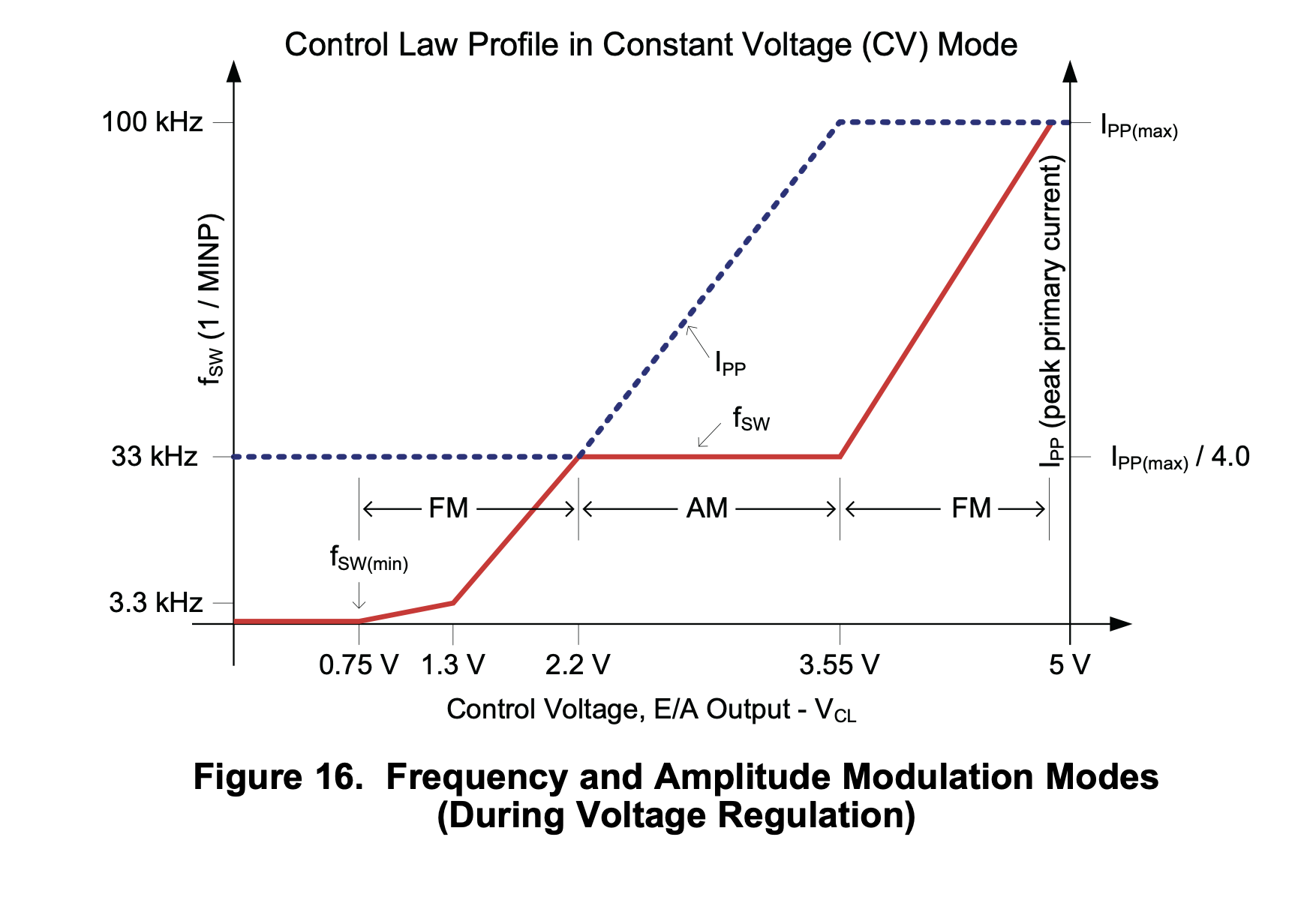

I am working on a project which requires an ACDC to power an e-meter. I am looking for a QR controller which can operate above 100 kHz to minimize the size of the transformer. I realized that none of our QR controller can go above 100 kHz. Am I missing something?
