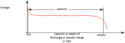

    4. The cells should have a voltage vs charge curve which shows a capacity.  For 6 Ah cells there should be at least 6 Ah, usually there is some margin.  With the cells together in a battery you should have 6 Ah capacity or more between OV and UV, passed charge should show that.  If your passed charge is showing less then the pack is likely imbalanced or a cell has lost capacity.  For example if you only get 5 Ah from the pack and cell 1 goes to UV first and cell 2 goes to UV first, you can see that cell 1 is at a higher SOC and cell 2 is at a lower SOC.  Cell 1 needs to be balanced down some.  Cells 3 and 4 may need balanced down some also.   As another example if you only get 5 Ah capacity between OV and UV, and cell 1 goes to OV first and cell 1 goes to UV first, cell 1 has lost capacity  Balancing won't help.
    If your gauging algorithm knows the SOC from voltage and you can measure the voltage difference, you can estimate as you indicate.  The data sheet from the cell manufacturer may give information from the curve for you to predict.  It is hard with cells with a flat voltage curve.  In the middle of the range you can't tell from voltage if there is a 1% SOC mismatch or a 10% SOC mismatch.

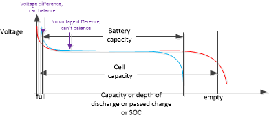

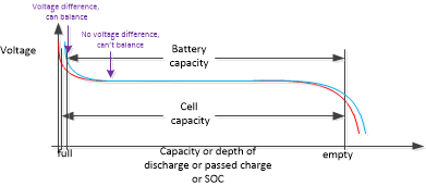

  • Hi Bilal,
    2. I made a typo early on.  You must forget it.
    See cell balancing for BQ76952 in this video starting 5:55.  https://training.ti.com/bq76942-bq76952-battery-monitors-fet-configurations-and-cell-balancing
    You need to look at your voltage curves for your cell.  See your manufacturer.  It will have some representation of passed charge at a certain rate.
    When the cells match but the SOC is different, there will be a voltage difference you can see.  If it lasts past the charge current stop, you can set thresholds to balance.  If it falls so much that there is no voltage difference, BQ76952 can't balance by itself.  If the host knows what happened, it can control balance.
    If one cell loses capacity, it goes to OV and to UV first.  Balancing may align the cells at the top, but can't fix the capacity difference.

  • Hi Bilal,
    If when charging one cell is 3.4V and one cell is 3.6V, the BQ76952 can see the difference and if the threshold is set properly it can balance the 3.6V cell.  If the charge current stops and the cells read 3.333 and 3.334 V even if it has been set to balance during idle the BQ76952 won't balance because it won't be above the idle balance threshold.
    BQ76952 is always voltage based balancing.  For SOC based balancing the control must be done by the host which knows SOC.
    "... in the first graph ... when the cells match ?"
    The blue curve for a second cell is the same as the red curve.  Any other cells are also the same curve and are hidden by the red curve.  All cells look the same in voltage and have the same capacity.  It is an ideal case.
    "do you mean that cell 1 (Red) and cell2 (possibly blue) are having same voltage but cell 1 (red) has higher capacity than cell 2 , thats why we have SOC diff ?"
    In the second picture the cells match but one has more charge.  Same capacity of the cell, but they are offset by some charge, shifted horizontally on the curve.  So it has a SOC mismatch.
