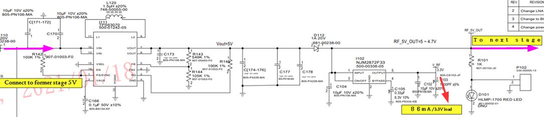

We use TPS63070 in our system. As title, we cascade five TPS63070 and Vin = 5V, Vout = 5V. Iout =100mA in every stage. The system is stable when cascade 4 stage. But if we cascade 5th stage, the system will not stable.
Could you help do the measurement or simulation for us to check if cascade five TPS63070 is not feasible.
