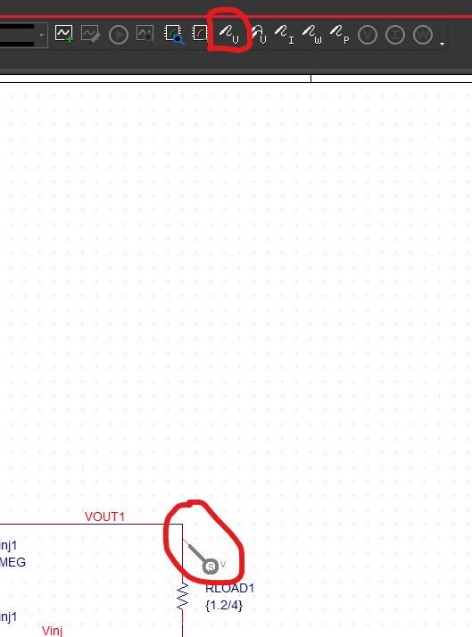

Hi Team,
I am try to simulate my design in Pspice with TPS65400 Transient model (SLVMAI5), I have not customized anything in SLVMAI5 but getting below error. Please suggest any idea to solve.
Dharma

Hi Dharma
You may add a marker to the output such as a voltage marker as shown below
After that you may still encounter the INFO, please click on OK
Then still click on OK
After that, you can get the simulation result. If there is any question, please let me know.
