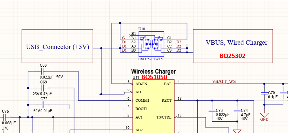

I want to incorporate to wireless charger BQ51050, a wired charger Bq25302. For the above, I need add a blocking back-back FET (CSD75207W15). Is the schematic enclosed OK?. Thanks,
