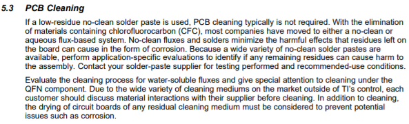

    3. Is it recommended that no clean solder be used during  fabrication
    We do not require no-clean solder however it can be used. Please refer to the app note QFN and SON PCB Attachment for more details, but below is a screen shot of the relevant section.
