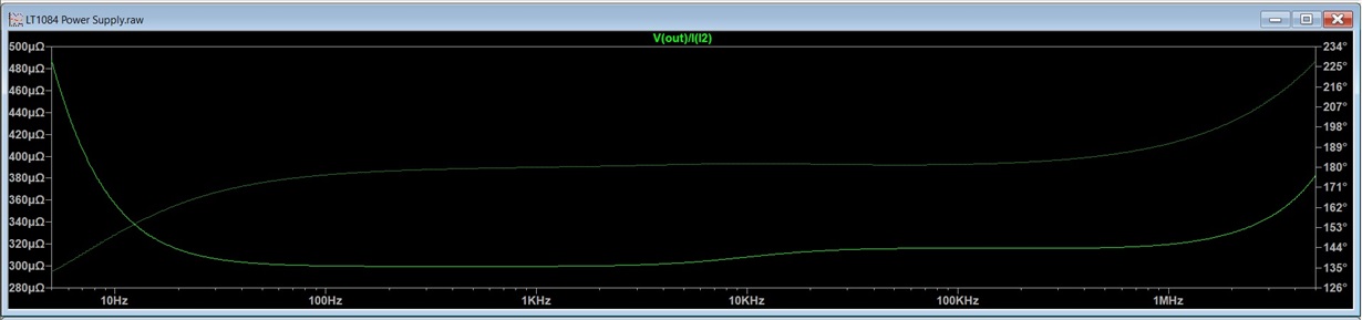

  • Thank you Jason for your response. On the output of the LM1084 I've decided to go with a 10uF film capacitor in series with 0.1R resistor.
    How accurate is the Spice simulation of the LM1084? For the following simulation in LTspice I get an output impedance of ~320 microohms from 20Hz to 20Khz. Is this a reasonable theoretical output impedance from the LM1084 under these conditions (2amp constant draw, 1amp AC)?
  • Hi Mischa,
    The PSPICE model for LM1084 is highly simplified and is recommended to demonstrate the basic functions of the LDOs.  LM1084 is designed in the 1990s and at that time, there was no modern IC simulator, so our support is also limited. If you are using anything other than the ones that are recommended in the datasheet, to verify the stability, I recommend using the load transients method described in this app note. Hope it helps.
