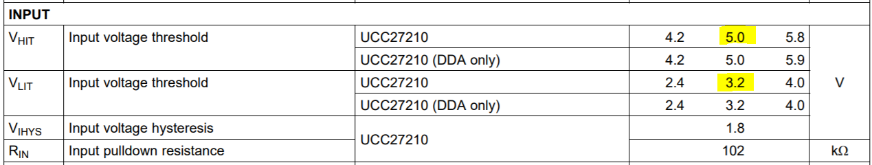

i would like to know if the gate driver can be operated with the use of a function generator to check rise and fall time, as i have attempted to no avail. or can it only be operated by micro-controller ?

    Yes, you are able to operate the driver with a function generator.  Please ensure that the function generator voltage is switching comfortably through the on and off threshold voltages (Table 7.5 from the datasheet).
    You may also want to configure your function generator in the "High-Z" output setting.

  • hello thanks for the reply what do you mean by configure. I am just following the layout from the data sheet.
  • Hello, Thank you for the response, I did as you said in the lab today but still no progress

  • Hi, Kehinde,
    In addition to what Aaron posted, verify, at the pins of the IC itself, that you have voltage from VDD to VSS that is within spec of the gate driver (see Recommended Operating Conditions).
    Focus on the LO first. The HO is complicated by the bootstrap capacitor. For more details, please see section 5.2.2 Bootstrap Gate-Drive Technique in this app note.
    Good luck with your project!
    thanks for the advice just tested it the lab it working thanks.
