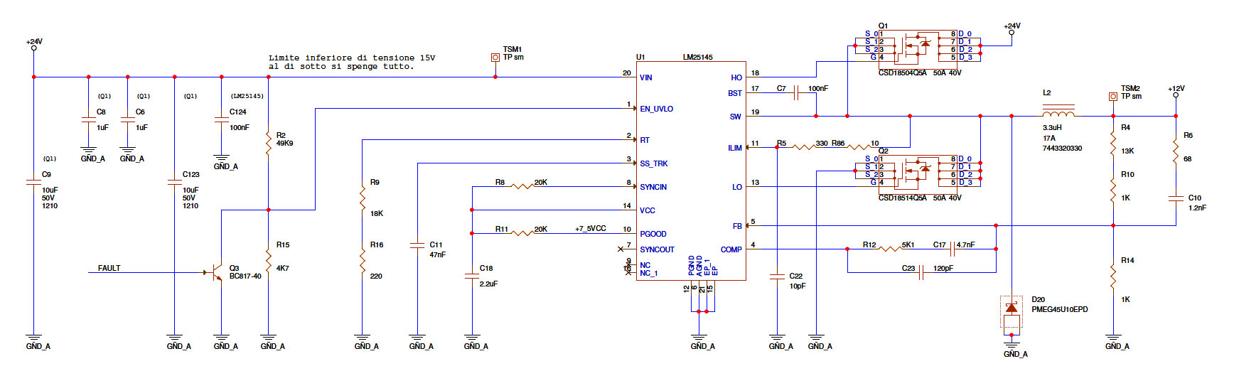

i'm working with lm25145, i have a board designed to regulate 12V output at 10A, starting from 24V input. The board is perfectly working. Testing this board on a load with 4A consumption, i see that IC and MOSFET temperature rise 27 °C more (from 20 °C to 47°C about). Can someone who has experience with these regulator tell me if that +27 °C rise, is normal or is too much? I am worried that if i put my board into a closed and unvented cabinet, temperature could easily arrive at 80 °C and the device could break soon.
Is there some documentation about failure rate over temperature for these regulators? Some MTBF tables, for example.
Can a +27 °C of temperature rise considered normal, for a power delivery to load, of about 48W??
