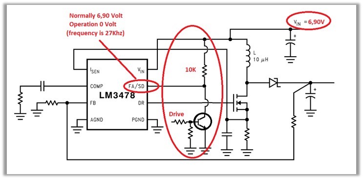

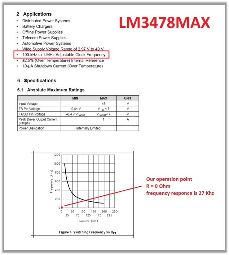

Although the datasheet does not cover, we have grounded the FA/SD pin. This way, device operates at 27Khz. Configuration:
1. Is there anything wrong to use the device at this operating point?

Hi Arda,
Thank you for using LM3478.
The recommended operating condition is 100kHz to 1MHz. For other values beyond this range, the performance will not be guaranteed.
