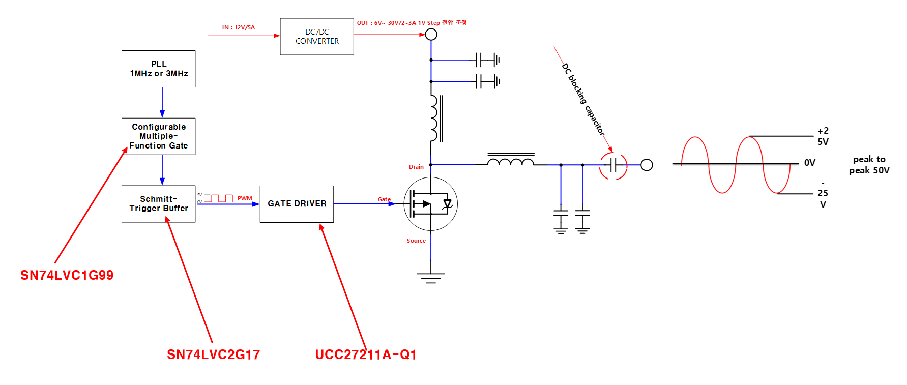

Hello TI experts,
My customer want to design the amplification circuit using half-bridge driver and MOSFET.
they drew a diagram for the convenience. please see the diagram below;
As you see there is UCC27211A-Q1 after 2 logic ICs.
the problem is originally generated signal is PWM over 1MHz to 3 MHz.
can you verify this diagram especially focus on the PWM frequency for UCC27211A-Q1? I cannot find ant data about this on datasheet.
(i already confirmed 2 SN74LVC ICs to another expert. it have no problem with high frequency over 1MHz to 3MHz.)
if it does now work, please recommend some ICs to replace.
please check this issue. Thanks.
