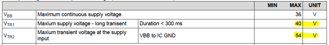

For Vtr1, it was spec'ed at 40V for <300msec
For Vtr2, it was spec'ed at 54V. What is the time period limit?
End application is automotive aftermarket control system. It operates at 24V, but need to withstand 60V load dump. Is there any spec for 60V? (i.e. even shorter time period?)
