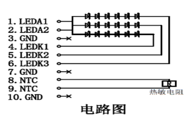

We are under developing one 5 inch TFT cluster Project,
and its backlight are 6series and 3 parallel for the backlight LED. Kindly find the attachment.

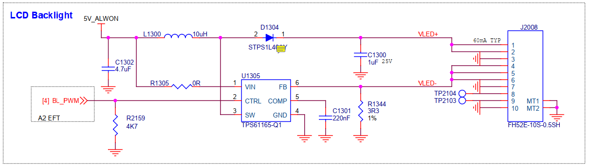

And we have enclosed also schematic diagram also, our LCD backlight will glow at 18V(VLED+) but did't get this voltage but we get only 5V,
What can i do..Kindly let me know,
Vin-5V
Vout-we need 18V but it comes 5V
CTRL pin has a 3.3V.
Kindly check and let me know.
