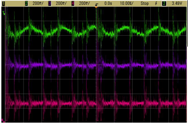

  • Hi Jason,
    Please see the attached file.
    Green : Vout 3.3V
    Purple : Vin 5V
    Red : (None)
    At low temperature (less than 10-degC), Vout of the LM1117 has osiration. However, after a while, the Vout stabilizes due to the self-heating of the LM1117.
    Therefor, we thought that the feed back loop frequency of the LM1117 is decline at low temperature, we added 10uF-cera-cap for output tantalum-cap. As a result, the condition of output voltage improved.
    Please give us your opinion on this consideration.
    ACGUY
  • Hi ACGUY,
    It seems to me that you may have noisy ground when taking the scope shot, as all three channels are having similar spikes. On top of the higher frequency spikes, I can see that the output does have some oscillation.
    For the LM1117, due to the age of the device, we have very limited resources available. It's best for us to confirm this type of behavior in simulation, but we are unable to do so for LM1117 due to the lack of a design database.
    The datasheet is suggesting a 10uF capacitor, is it possible for your to try the one with the datasheet recommendation? If adding the ceramic capacitors makes the oscillation disappear, I would suggest doing the load transient check to confirm if it indeed solves the problem. More details can be found here.
    www.ti.com/.../snva364a.pdf
    Jason Song

  • Hi ACGUY,
    I am unaware of any situations where the LM1117 becomes unstable at low temperatures, but it looks like what is happening is that you are hitting the LDO with another transient before the LDO can stabilize from the previous one. Have you tried using a lower capacitance value tantalum? it may help you increase the loop bandwidth enough to improve the response time.
    My guess from the data you have shown here is that the low ESR from the ceramic is allowing the LDO to respond quicker, but it doesn't look like a stability problem it seems to be that the transients are happening when the loop is out of regulation still.
