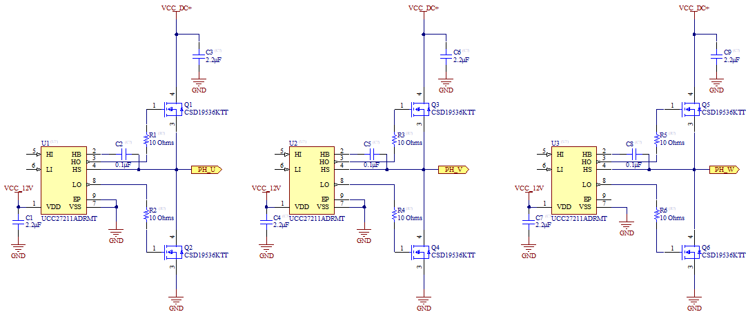

Dear,
I am designing a BLDC power stage around CSD19536KTT Mosfet with this :
As you see it is a very minimum design, when looking at TIDA 00281 I saw that there are a lot of "protection" around mosfet :
My questions :
1) Since CSD1953x are not pretty new component I was wondering Is there are any Mosfet which include these type of protections ?
2) These components (RCD and TVS) does really improve performance and protection ? and what is your recommendations
Best Regards
