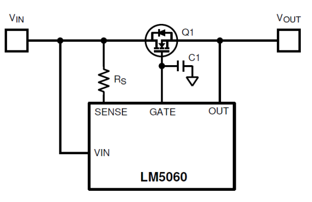

Regarding to the following three ICs, please help to confirm if Rg and Rgs for driving MOSFET is necessary or not.
We can’t find the related information from IC datasheet and application note.
#  LM5050-1-Q1: Is Rg and Rgs for Q1 and Q2 necessary or not? Is any suggested value if it is necessary?
#  LM5060-Q1: Is Rg and Rgs for Q1 necessary or not? Is any suggested value if it is necessary?
BR, Gary

    On the other Hand LM5060 is designed to drive an N-Channel Mosfet in  an orientation (Drain- Source) which blocks forward current when the FET is disabled.
    • For LM5060 a capacitance at gate can be used to slow down the startup and limit the inrush current. This is helpful while starting up into a big output cap.

  • Hi Gary,
    For Q1 driven by LM5060, you can use Rg and Cg in series from Gate to GND.
    For FET driven by LM5050, there is nor requirement for Rg or Rgs. Please refer to datasheet for more details.
