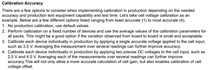

    In Section 2 of the guide, it describes some different options for calibration. The code example covers option #4 in this list which is the two-point calibration. When you calibrate each cell voltage, you need to provide a precise voltage to the specific cell you are calibrating, so using the BAT+/ BAT- terminals only (using a resistor divider) is not going to provide the most accurate calibration because the resistor precision will come into play.

    Ideally, you could provide 2.5V to all cells simultaneously (this is what I did for this example) and then provide 4.2V to all cells simultaneously. The steps and calculations are described in the guide and the Python example code is going through these steps as an example. The hardware and software for a real production solution would not directly use this example code - you would need to find the most efficient and cost-effective solution for your BMS.

    We have other hardware internally - this code was not run using the EVM. You can use a resistor divider like the one on the EVM for calibration - but the calibration will only be as accurate as your resistor divider. The device has good cell voltage measurement accuracy without calibration, so you would need accurate voltages to calibrate to improve it further.
    You will not be able to run this example code directly - it is only provided as an example. The BQTools SDK is used to enable PC to EV2400 communication (an EV2400 circuit is included on the BQ76952 EVM). It can be used to create a custom production solution with many of the functions from BQStudio. It does not work directly with this Python example.
    The bqcomm Python library is similar - it allows the used to send I2C commands from the PC to the IC using the EV2400 circuit. You could interface to the I2C with a different tool or with a microcontroller. For example, there are MSP430 code examples in the BQ76952 product folder and one of the examples goes through the same series of commands as the Python script included in the BQ76952 Software Development Guide (https://www.ti.com/lit/an/sluaa11a/sluaa11a.pdf).
    Ultimately, BQStudio provides a way to do calibration on the EVM in the Calibration tool window. This is a single point calibration. If you want to do a 2-point calibration, you will need to use a microcontroller or another tool to interface to a PC.
